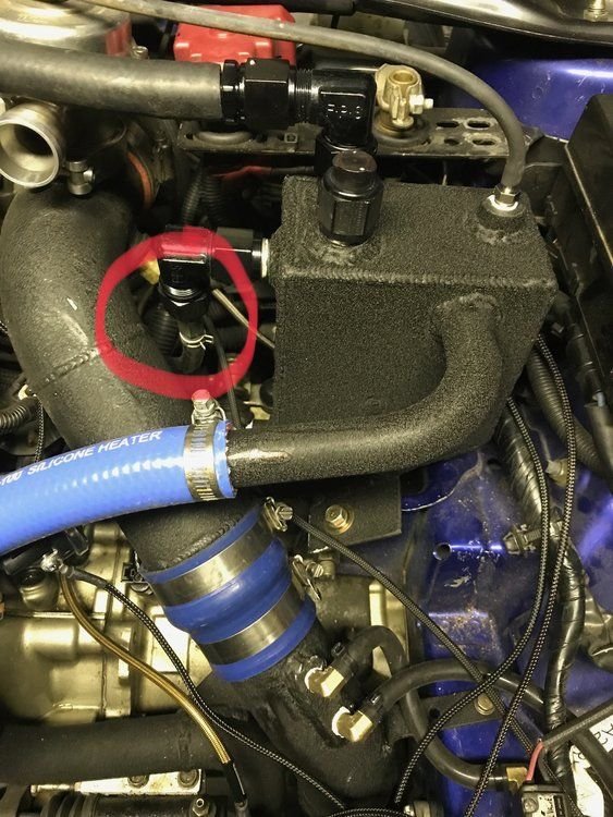

I unscrewed the 90deg part of my pcv valve and adapted just the valve portion to the end of a -10an cap. Kind of hard to see, but in the pic is the outlet of the pcv valve angled down.

Also, pull the PCV valve and spray it out with carb cleaner to make sure everything slides around freely. For the intake manifold PCV you only need to run the stock valve and a 5/16" hose. Regarding the check valve on the catch can after the secondary air injection pump, it is a piece I got from NAPA that is 3/4" hose barb on one side and 1/2" NPT female on the other side. I'll check my old thread to see if I detailed the part number. (checked....did not say)
