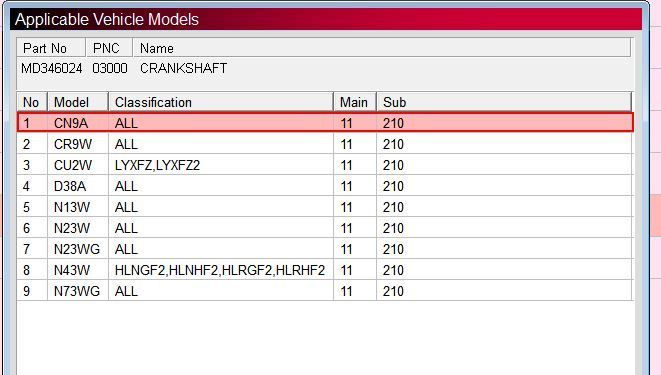

Exclamation
Ok i did some research with the Mitsubishi ASA!
Connecting Rod : MD193027 - same as Evo 1 and 3
Piston: MN176886 - unique for Airtrek
Head gasket: MD346741 - MLS head gasket same as Evo 5 and 7
Crankshaft: MD346024 - same as Evo 4
There you go - a real parts bin car! haha
