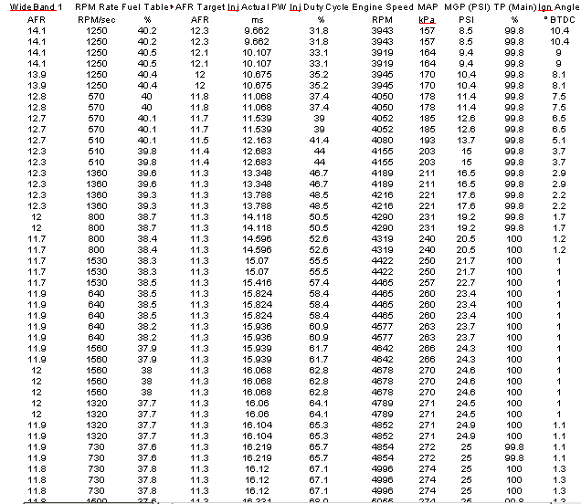

Interesting, again the car kinda copied was the PA build and they had great spool. Ported head and fuel is the only real big changes ( **** displacement too ) which I will agree are huge. Maybe that set up just works better on e85? Did a quick log this morning to check just waste gate pressure with the new springs see attached. I did not believe that t3 ts 1.01 and 35 wheel would have been not as responsive as I had hoped especially due to back pressure down low. I will add that it has a hks sport exhaust and a 3.5" exhaust is being considered. I will get real screens of the log here shortly

Hard to tell what is going on in that log so perhaps change the x-axis to RPM and I assume you have a different scaling on the y-axis on the right. Here are my dyno and street results comparing the Gen I GTX3582r (6262) vs the S362 SXE (6268). Your 2.4L should be no worse than mine in terms of spool and in reality it should actually be better.

Heres a quick screen grab of the log. sorry im using open office in this old laptop lol.
this is just wastegate spring and appears to creep a little.

That does seem a bit laggy for a 2.4 but its still making 20 psi by 4300
I'd suggest running 11.2-11.5 . These are old engines and they live better there. Its not a K series.
Running it on the richer end of the spectrum will keep the heat down.

First pull of the season and coldest the car has ever seen. It was below zero.. I did add a couple percent to the iat correction tables after this.. I'm assuming that is an iat correction anyways.
It doesn't feel as laggy as the data would lend you to believe. Is that the twin scroll doing its job ?
