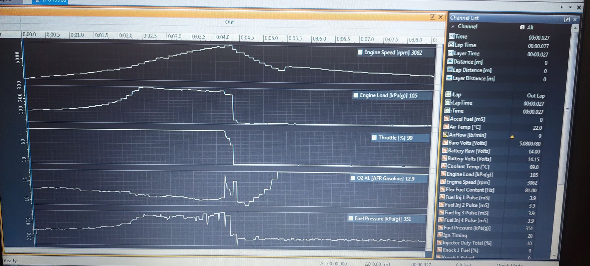

i have a aem pressure sensor on the afpr which take off too and install a mershell gauge a too adjust and then reinstall the aem pressure sensor again, i can see fuel pressure in my aem logs as well.
​​​​​​as u can see at the very bottom the fuel pressure, there is drop of 10-20 kpa around 7600 7700 rpms.... red line is 8200rpms.
*photo removed*
Where is your reference for the AFPR coming from?
Did you adjust to the 45 base pressure yet?
Could we see a log after you set the 45 base pressure with both fuel pressure and boost graphed? It doesn't need to be a full pull, just a little boost to make sure the AFPR is working.
