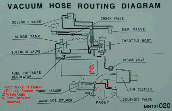

For what it's worth, I just moved mine from the BOV to the compressor. Not only is it simpler, I think it spikes less.
Old Sep 17, 2004 | 07:10 AM
stevEVO8's Avatar
Joined: Oct 2002
Posts: 634
Does any one have pics of it on the compressor line? and where this is at?
Old Sep 17, 2004 | 07:22 AM
juyanith's Avatar
Posts: 387
Er, no picture but I made a diagram. It's pretty easy to follow, click here: https://www.evolutionm.net/forums/at...chmentid=43028

your wastegate is operated by POSITIVE boost pressure regulated by a BC or the factory solenoid
personally, ill take the stronger, constant Boost signal from the compressor over one from the manifold that has lower pressure due to pressure drop through the intercooler, not to mention the manifold will go into vacum when the Throttle Plate is closed, making your boost controller nothing more than a nice clicking black box, leaving your Blow-Off-Valve or By-Pass-Valve to control the boost on throttle lifts
