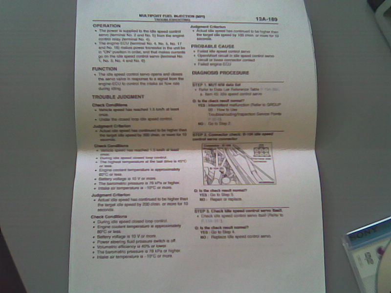

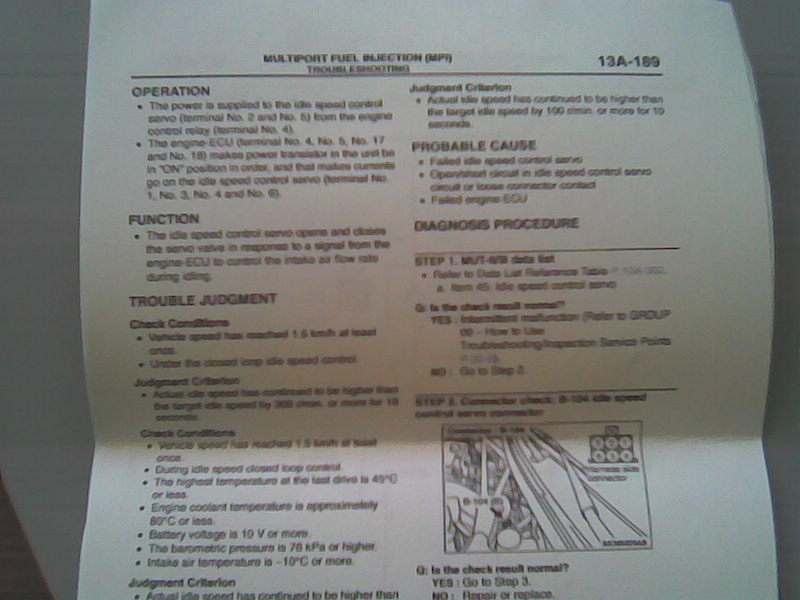

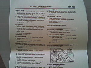

i had a check engine becouse of that.
i will post details tomorrow...
you will just have to clean an accelerometer plug!

1. failed idle speed control servo
2. open/short circuit in idle speed control servo circuit or loose connector contact
3. failed engine ECU
These are the 3 cases for that...the most probable is the connector!
Attached Thumbnails 3rd GEAR NOT SLOWING DOWN!-image036.jpg   3rd GEAR NOT SLOWING DOWN!-image037.jpg
