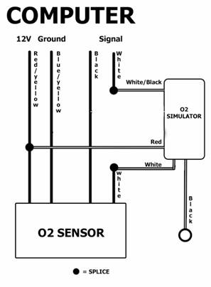

Old Mar 8, 2006 | 06:28 PM
forbidden color's Avatar
Joined: Dec 2005
Posts: 459
From: GA
here is the installation. Did you cut the white wire that you've installed the 02 simulator to?
Attached Thumbnails Question about AEM Eugo Wideband O2 sensor-clip_image002.jpg
Old Mar 8, 2006 | 07:17 PM
P0411's Avatar
Joined: Dec 2004
Posts: 56
This is exactly how I installed it.
Old Mar 8, 2006 | 07:27 PM
Joined: Dec 2005
Posts: 459
From: GA
i would reset your ecu, check your ground, make sure it's grouding well. It might be that your 02 simulator might not be working.
no ground, no power.
Old Mar 8, 2006 | 07:42 PM
P0411's Avatar
Joined: Dec 2004
Posts: 56
But thats what I dont understand?? I uninstalled it once already and re-installed it. The light is blinking on the simulator so I know its getting power and its grounded correctly. I also have hooked up both of the other wires on the sim correctly as well....so I dont know what the **** is going on??
