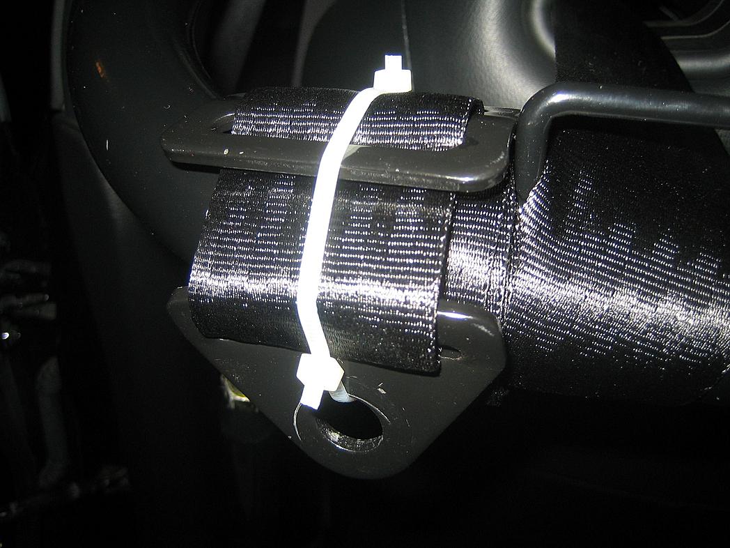

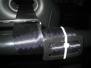

Heres my ghetto rig now.
By the way, I'm not actually using these right now, so don't freak out!
You can see in the pictures, the thing where the bolt is supposed to go through, that I tried to take off. (It has a zip-tie thru the hole)....
Problem was that it was stitched in there. The only way I see to take it off is to cut it off, which would mean cutting where the harness was stitched. Either I'm just stupid, or I have NO IDEA how to put this on.

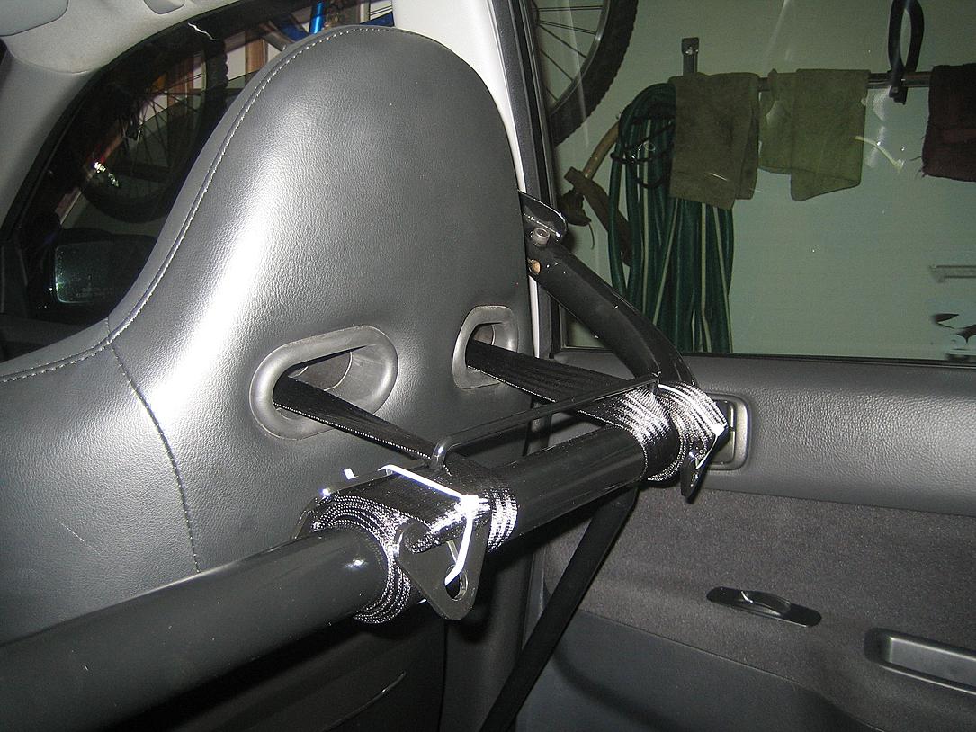

ok, heres your problem, mine are still on you cant see them in the pics but mine are still there they just hanging, the adjustment piece, i see them in your pics..... that is the key, you have to take the harness apart, each shoulder strap should actually be 2 pieces (hence how you can adjust the length)
there is no bolt
no bolt goes into your harness bar, if you look at the pictures i provided there is no bolt theres just a method to looping it properly so it tightens on the bar the more its pulled

Ok, so If I'm understanding you right, you said that the back part of the harness (that wraps around the harness bar), pulls off from the other part of the harness? AKA the adjusting strap on each side of your shoulder?

Not to be a d*ck but thats no harness......might as well used the stock that came with the car, at lest they are takata
Just one wrap like how Chabada15 pictures show
Also if you are going to do something, do it right...get competition harness thats 3inch. <----I am telling you this cuz if you die dont blame me, lol. Yes you paid alil more....BUT you live, you live to fight another day =D

kinda basically you take the metal piece that you use to adjust the length (these are a crome plated piece in my pictures and you loop the harness thru that then around the bar then back thru that clasp in a perticular pattern, copy what you see in my pics exactly and it will secure it, i really cant help you more if you go out to your car and play with it it might help
