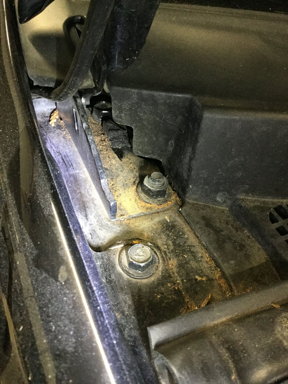

Originally Posted by AzNvPo4sHo View Post
Today in the morning as I entered my car, I smelt a horrible odor in my car. At first, I thought it was something foul from outside. However when I turned the A/C on, it smelt even worst. So I decided to check my cabin air-filter and found bunch of shredded groceries bags in small pieces on top of my filter along with two dead mice. Not a good feeling at all !
I'm wondering how did the rodents get inside of my car (literally above the cabin air-filter and blower motor, where it is blocked off by many thick hard plastics and such). Is there any holes or such under the car that the A/C vents out to the atmosphere?
Thanks!
I know this is old but I just had the same problem. They get in to the vent system where the hood hinges are (open your hood you'll see a 1/2"x 1" piece of rubber), there is a small piece of rubber that stops anything from getting into the vents.
jwestIX is offline
