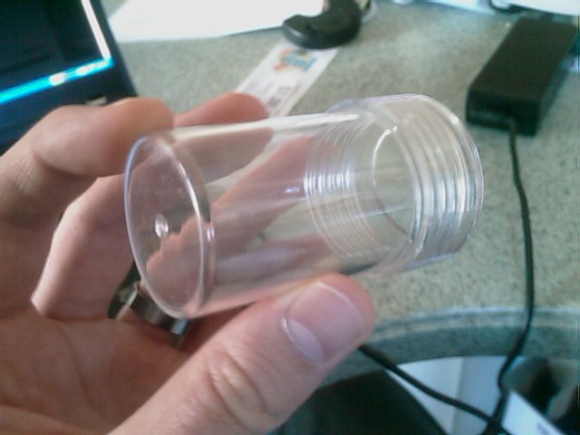

Fixed !
Attached Thumbnails HID Question ! need help !-2010-02-20-13.36.45.jpg   HID Question ! need help !-2010-02-20-13.37.10.jpg   HID Question ! need help !-2010-02-20-13.37.00.jpg

When you take the hid bulb and place into the projector, does it sit flush? And is there a wire clip that wraps around the bulb to secure it to the back of the projector? What kind of hid kit is it and what type of bulbs did you remove?

From the pictures you posted. Your new bulbs come with a clear plastic casing that is there to protect them during shipping. you unscrew it and the top comes off, then you back the bottom off the wire. Then you plug the bulb in(don't touch the bulb).

As long as the hid kit you purchased is a 9006 kit, the bulb will seat into the projector just like the factory bulb. And just like rgar said, remove the plastic case that surrounds the bulb. I like to use latex gloves when I'm messing with hid bulbs.
