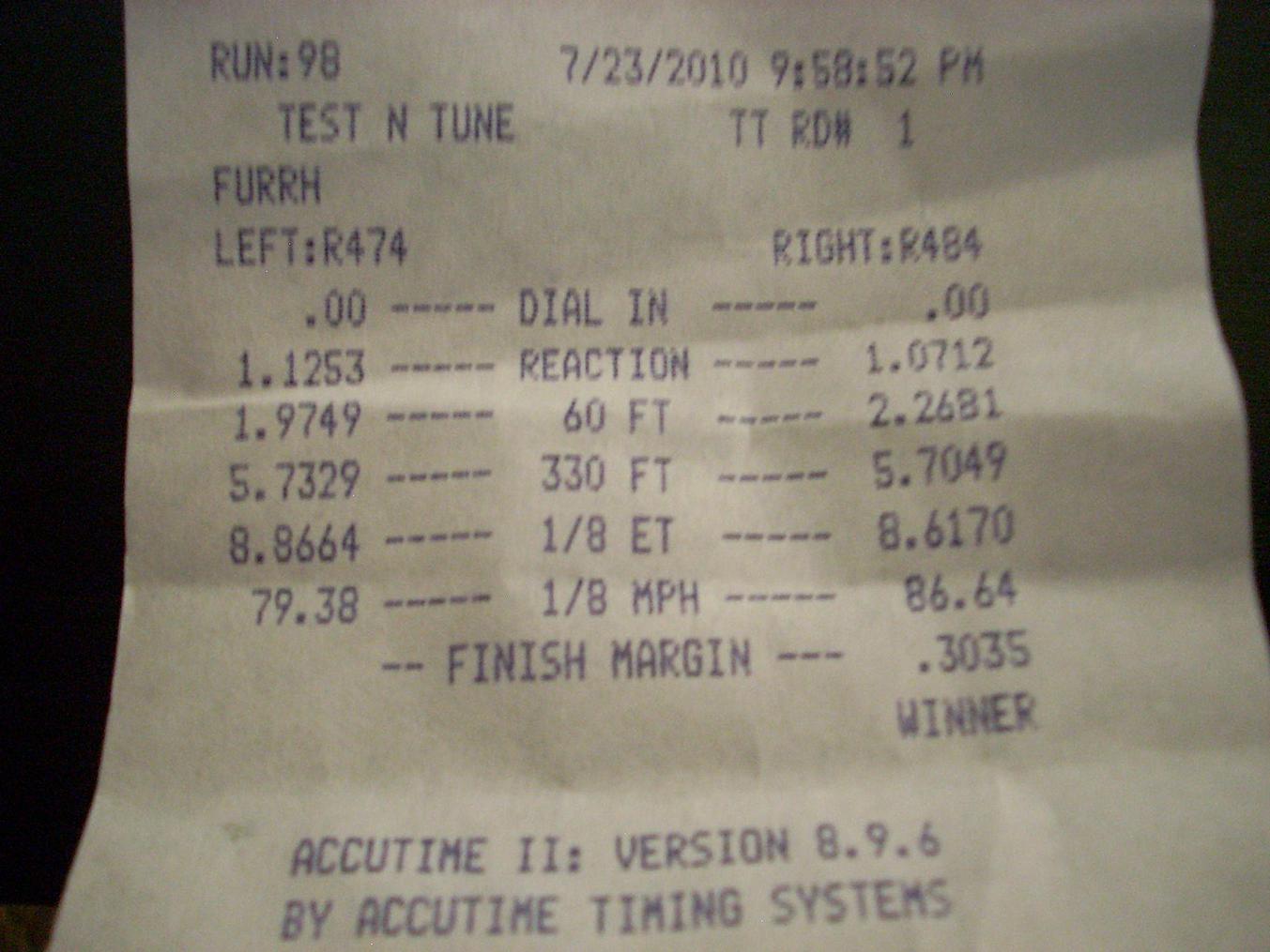

This was my first ever at the track (1/8). Mine is on the right. Left was bolt on EVO
Mods.
BR bloock 2.0
BR head
FP RED
1200 INJ.
ETS LICP,UICP
Perrin FMIC
APS twin-vent BOV
Ported intake and exhaust maniforl.
and the usual TBE, intake, and MBC.
tuned by Mellon 93 pump around 400HP.
I could not do the 2 step launch as my car was reving up all the way to 7K.
When the car builds up Boost at 7K, I get a flashing SES light.
SO there were no 2 Step Launch on this day. just straight rolling out of the gate as you would on the stop light, but WOT. Look at my 60FT LOLOL....
1. Is 2 step suppose to take my RPM to 7K? and SES Flash?
2. Just looking at my slip(no launch) what would be my 1/4mile time? Around..
Thanks guys

I'm guessing high 12 low 13 on the 1/4

you'd have to pull your rom and open it up to see what your stationary rev limit is set at. After that the CEL Flashing it's Tephras knock cell mod. Your car is knocking at your stationary rev limit

What should I run on 1/4 mile with a good 2 step launch? at 410/360TQ..
