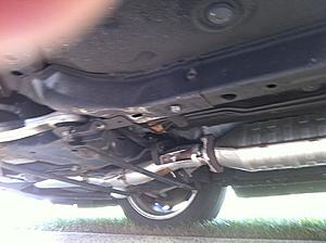

The best I could get.
Totally ghetto style, the best way I could get under the car.
Attached Thumbnails Help me build a monster...-img_9656.jpg   Help me build a monster...-img_7170.jpg   Help me build a monster...-img_4595.jpg   Help me build a monster...-img_1577.jpg   Help me build a monster...-img_6694.jpg

ok so thats a stock intercooler and stock exhaust system LOL look like only thing aftermarket is a intake so all stock and of course cant check out the tune so basically stock like evo so now get the tune checked out compression and leakdown test if those come back good then your ready to start modding
