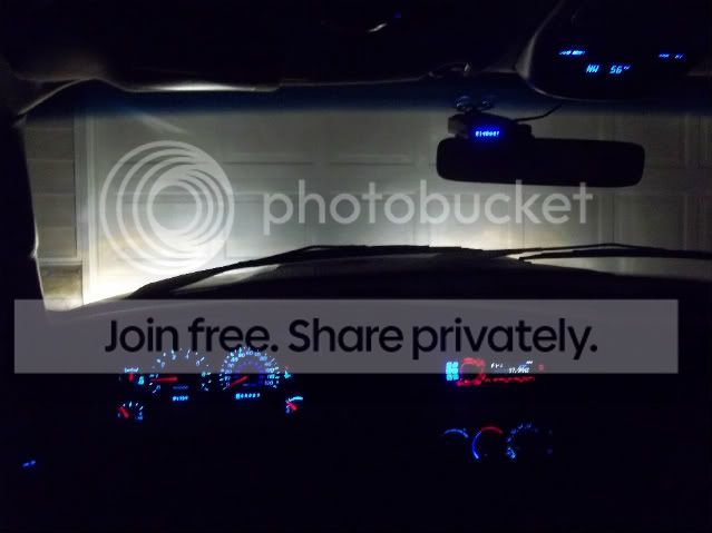

I did this with my dodge ram... I haven't looked at the back of our hvac panel to see what bulbs it uses or if you use that gel paper to change the color. You can get pretty much any kind of led from superbrightleds.com. I'd like to change it to orange/red as well. It looks sharp.
Here's my truck that I changed over to all blue:
