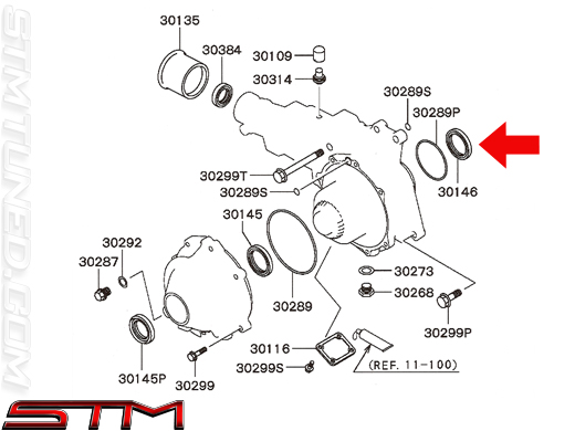

I am beginning to think that a good sealant could fix this rather than: pulling the tcase, opening the case, reseal, then reassembling. My concern is If oring part number 30289 from the 2nd pic is what seals this area. Otherwise, if its just metal on metal flanges with silicone compound between, some more silicone should work to fill in whatever gap just fine. Hoping anyone thats opened up a tcase can let me know their thoughts. Thanks

I would talk to the shop who did the install and also the shop that rebuilt it and see what you can work out. If I had to guess I would say its the o-ring seal which is not a big deal other than the labor to get to it. Get it fixed right, dont silicone it.
