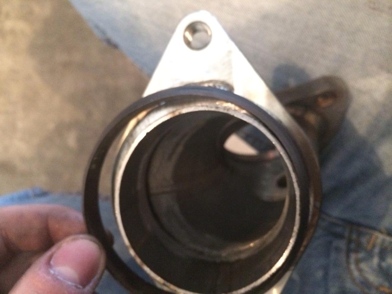

I have a greddy 3 inch down pipe and the the diameter of the o2 dump is much smaller. what do I have to do? the ring gasket on the exhaust seems to not fit the o2 and is too big I think.
How do I solve this?

Are you trying to connect the 02 dump directly to the downpipe or are you using the donut gasket in between?!

The donut gasket just seems too big for the o2 dump... Won't it leak? Or am I wrong?

Is there supposed to be a smaller donut gasket for the o2 dump or what? really stuck here..

That's a awfully small/thin donut gasket

was there a donut gasket that was supposed to come with the o2 dump?

It's suppose to be a 2.5 inch Oem donut gasket that looks like the one from a invidia 02 housing which is incorrect

I reused my oem donut gasket.

Wowww.. Thank you guys! I'm off to the dealer to buy the OEM gasket.

Definitely reuse the oem gasket. Good luck

Yep! Make sure when you install the MAP o2 dump, the donut gasket is OEM.
