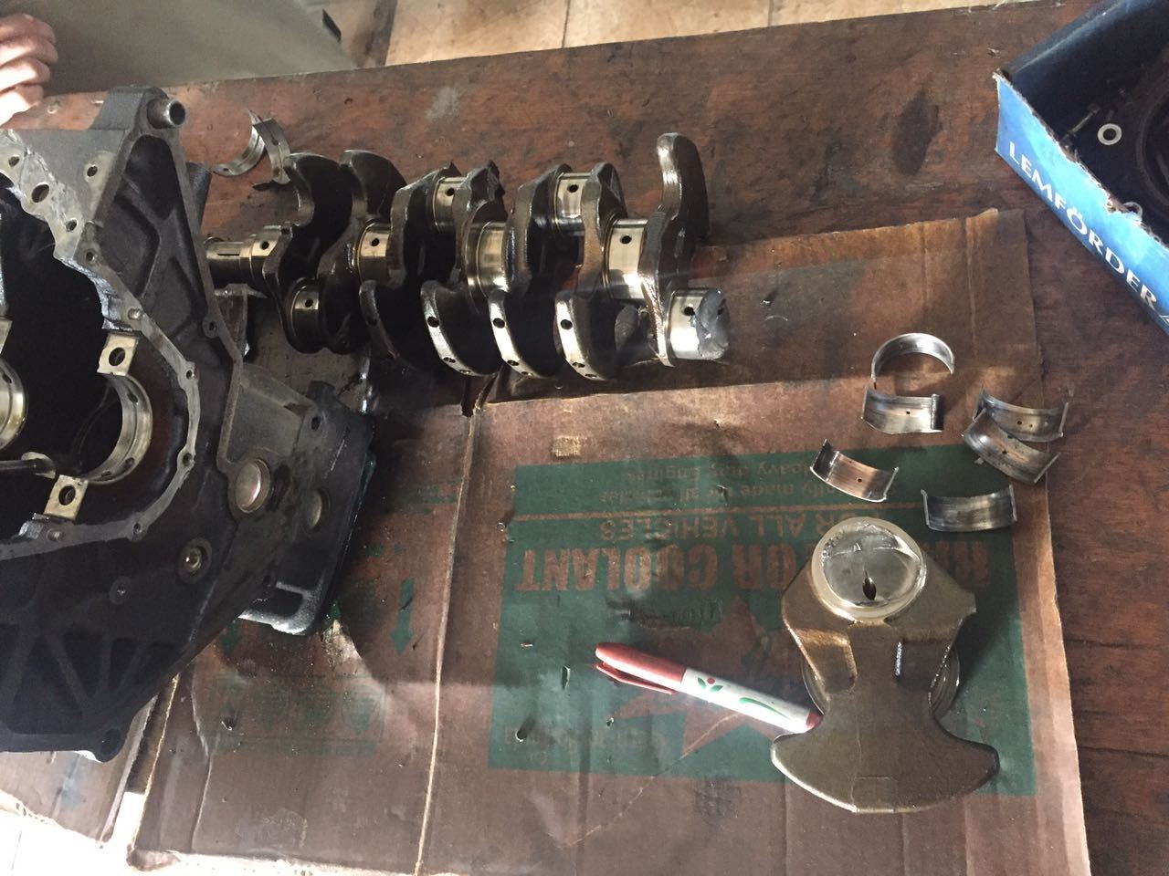

so the noise was a broken crankshaft and if messed up part of the block that was the grinding noise at shifts, i got a new block with a new crankshaft and bearings. and now moving all the other parts to the new block (pistons, head, etc). expensive job
