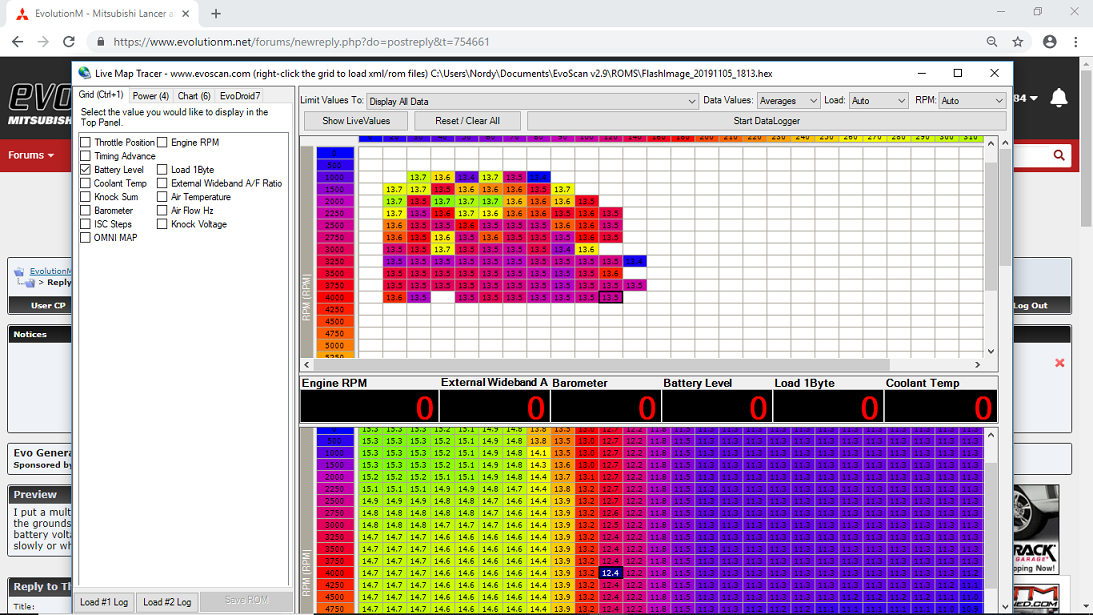

I put a multimeter to it after i got home and afr were back to normal. The readings checked out. Car idling 14v. The battery is in the trunk and the terminals look new. I guess i can check the grounds and make sure theyre ok. What gets me is every summer it seems to do something like this. As if heat has something to do with it. Checking some of the logs one evoscan battery voltage is usually in the 13s. Ive always had a lean take off issue and nothings fixes it. I notice in some logs around that area ive seen voltage as low as 13.1. Can an alternator fail slowly or when they fail they fail and thats it? I mean maybe fuel pump is going bad again but damn this would be the 3rd one i think would be going bad because of similar issue. It cant be. I havent done the pump rewire. Maybe it needs that? idk i just think its weird specially when i disconnected the negative battery cable and car turned off.

I bought the car with the battery relocated. So when I turn the car on cold voltage reads 14 - 14.05. Now after driving a bit it’s 13.8 ish and i took a video where you can see when the fan turns on it’ll drop to 12 for a second and pick back up to mid 13. Don’t know how to post it. I guess I should check over all grounds but I’m also thinking this can be fueling issue some how. This car is going to drive me crazy.

That's not good, you do have some kind of issue with that kind of voltage drop. Voltage across the system effects everything, how fast the injectors open and close, the fuel pump etc.
