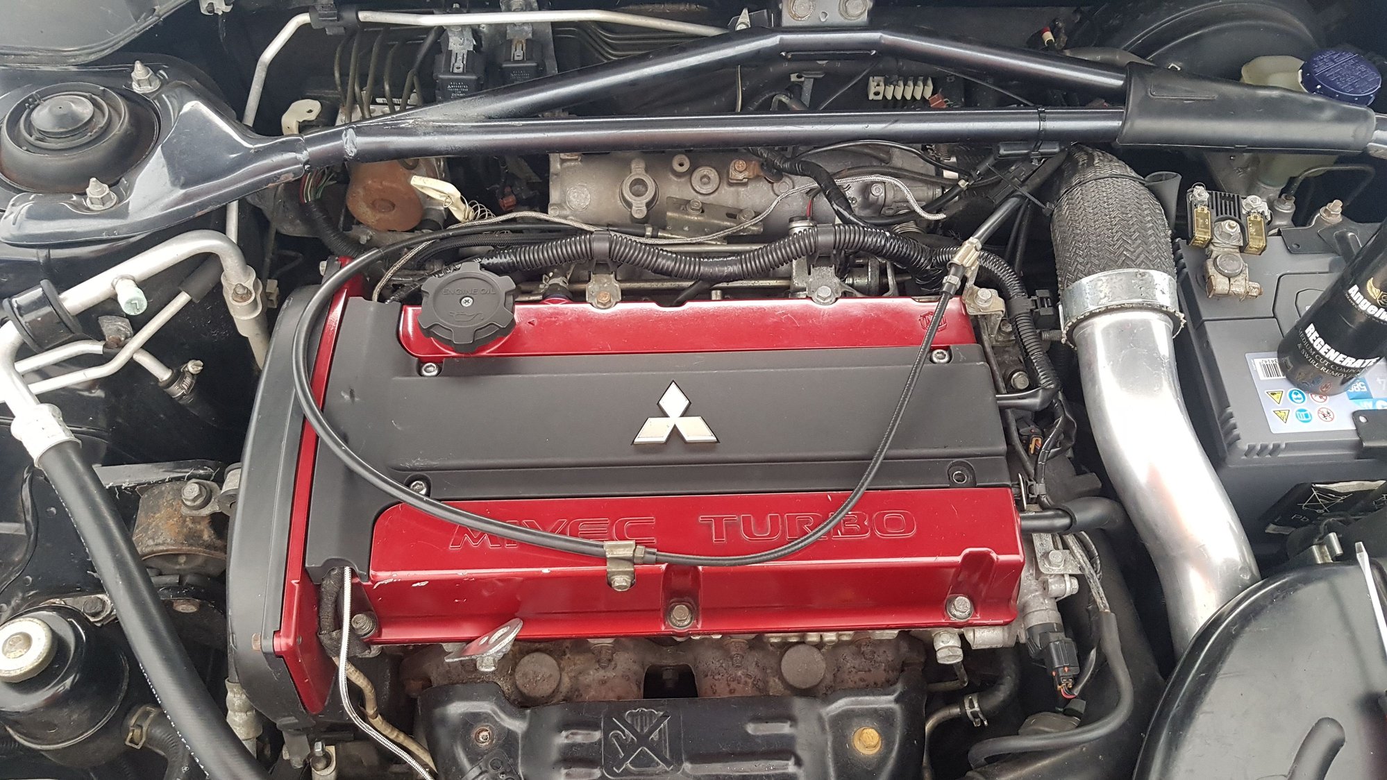

I Will add some pics of the engine, and engine bay
This is the block with the evo 9 water pump that don't fit
Rods
Engine bay
Fuel rail pressure sensor
Another sensor connected in the intake mainfold

I call It Frankenstein Just because it's an Evo 9 with evo 6 short block and a mivec head and evo 10 injectors and adapted fuel rail... but if this pretty much a normal value for this setup and the HP so i won't investigate more, btw, in planning to fix all this mess in the future because everything in the engine bay it's adapted and normal spare parts won't fit.... thanks alot for your explenation
