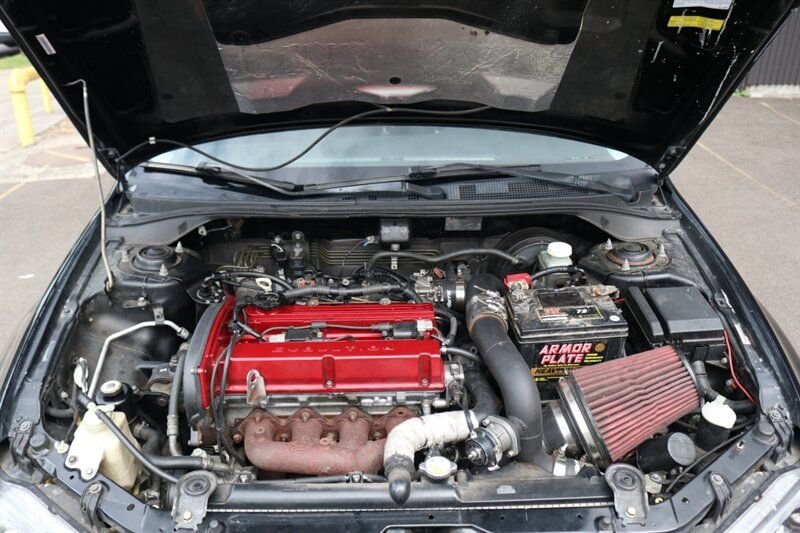

Well, it kinda looks like the owner had set up the EvO for the drag strip as the front strut bar has been removed. Looks like it has a cast FP exhaust manifold & the EvO looks like it has been run in the wet as the mani has surface rust. The mani is also missing an exhaust mounting stud. Looks like the engine has been modded for Speed Density & has VTA blow-off valve. Likely has a aftermarket FMIC & intake pipes. Looks the brake master cylinder has a brace on it (i run one as well). No suspension coilovers. Ignition coils looks stockish.
The other questions would be health of the engine, miles, engine mods, chassis quality (no rust) etc, etc.
Not much can be had from just the engine bay pic but it does give some info

Lip is chipped up, not a huge deal. Car is missing a fender bolt, worse a missing exhaust manifold bolt (A tener says it’s snapped off in the head), as well as non standard blots throughout the engine bay.
#1) I’d definitely throughly check underneath the vehicle , you’re looking for where the front and rear subframes connect to the unibody and the rear subframe back They are known to rust very badly in those areas if moisture, salt, have gotten at it w/o checking and protecting these areas over the years. Seen some here in the Notheast where it would cost more than the cars worth to actually put right even though exterior looks mint.
I’d say it’s most definitely been drag raced. No strut bar as mentioned and an FP Black turbo. Car is going to be a little laggy on the street with that FP Black not too terrible but plenty to notice, especially if you’ve ever driven a stock turbo Evo or any other stock turbo sports car.
