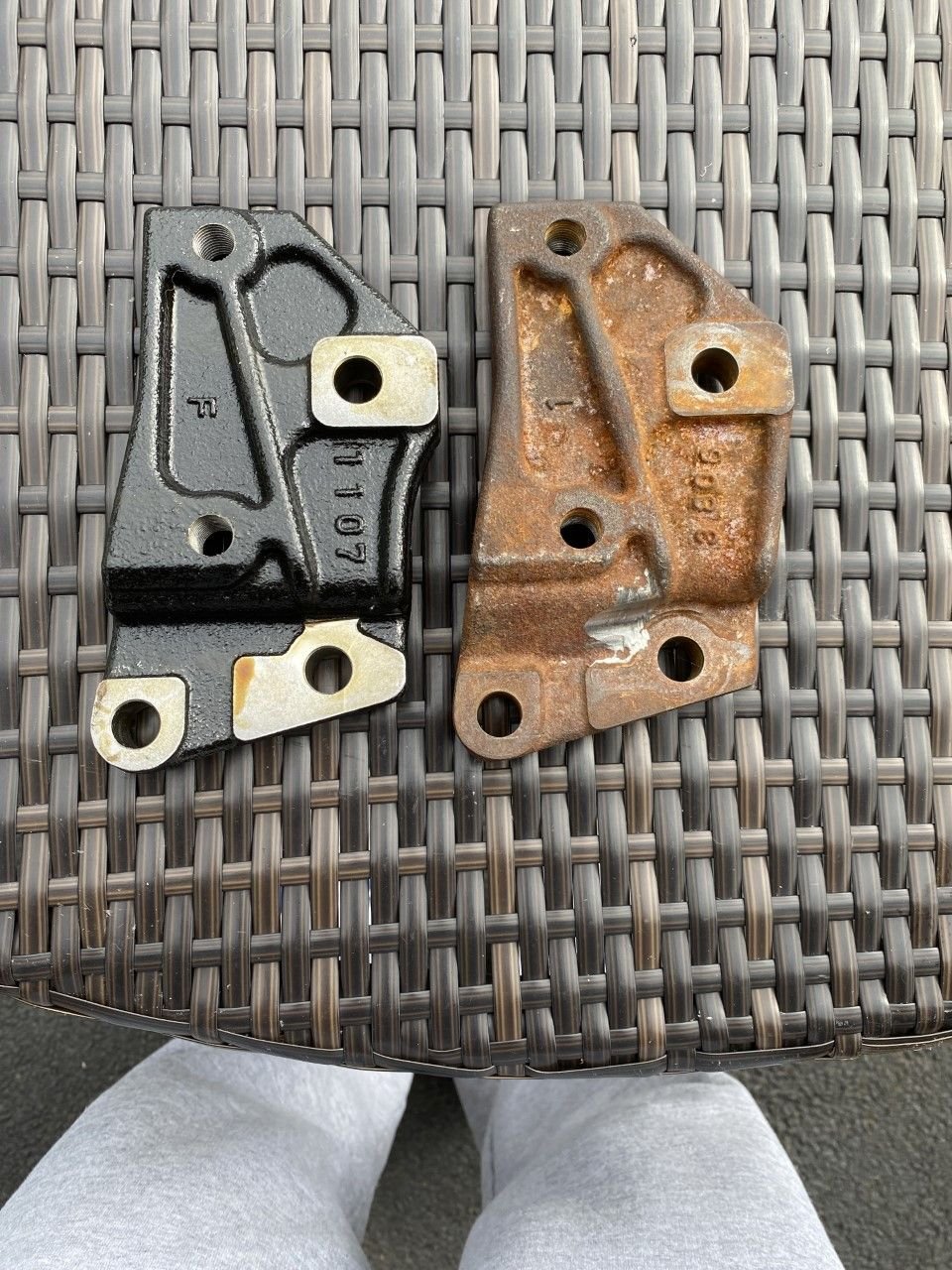

Old Oct 11, 2021 | 09:36 AM
Zaneithan's Avatar
Joined: Mar 2021
Posts: 21
From: NY
Originally Posted by ayoustin
I'd be interested to see a side by side comparison photo.
As requested. You can see where I tried to grind away material on MR553966 to try and make it fit.
Old Oct 11, 2021 | 10:22 AM
Ayoustin's Avatar
Joined: Jul 2014
Posts: 2,989
Likes: 648
From: SC
Thank you, this is super useful. I just finished up my design for a billet aluminum version of this part and it looks like the stock part I measured out was the old version. I'll have to double check fitment on a 6 speed as I've only checked on a 5 speed as of right now.
