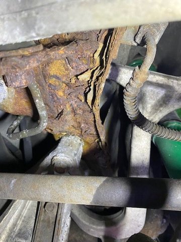

Does anyone have experience with rust repair at rear frame mounts? The car doesn't have any rust to speak of except at rear mounts. Are there replacement rails available or do you need a wrecked donor car? And if so is a regular lancer compatible ?

https://www.autotorque.net/chassis-leg-replacement/
Old Jan 13, 2022 | 05:56 PM
Thats a good link above. No doubt that undercarriage has seen it winters. @Old schooler
At the very least it should be blasted to bare metal to see what there is to work with
A standard lancer does not have anything to offer to the EvO suspension (its all different)

Thanks for the info, I am going to sell this and just want to be sure buyers are informed that at least there are repair options.
