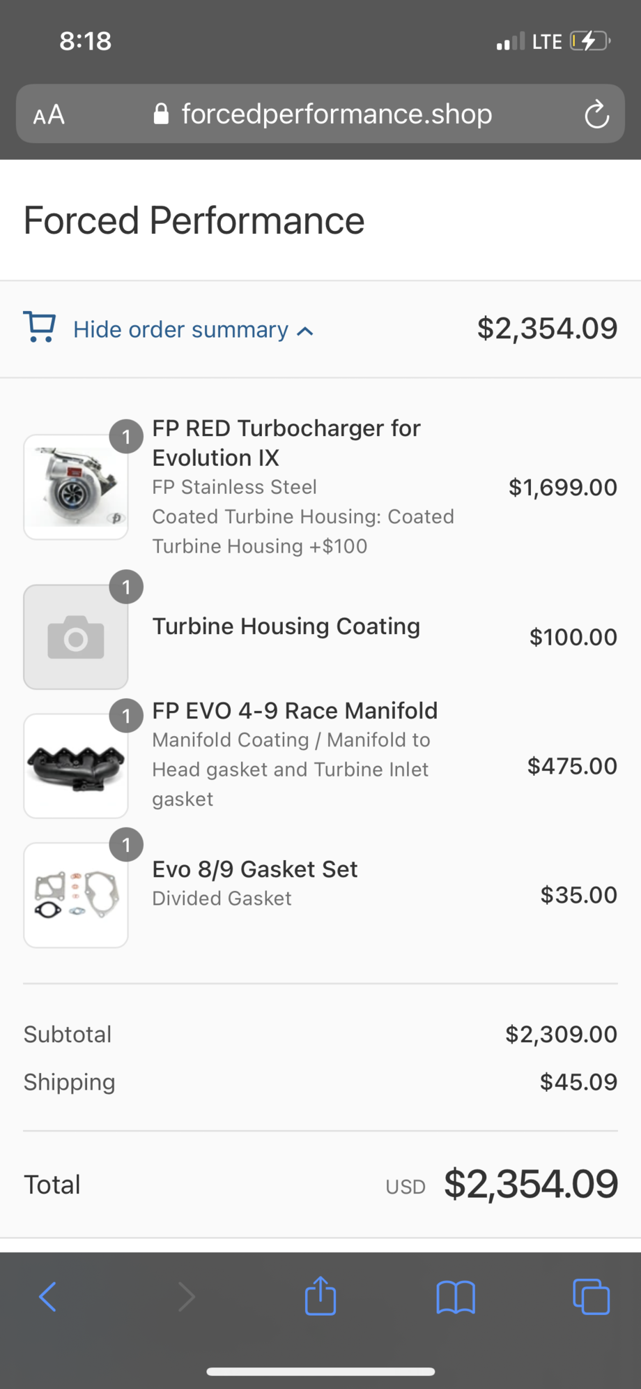

Leak down was done all numbers were good with 11% being the highest. Pulled exhaust on turbo and that’s definitely where all the oil was coming from. New parts on the way!

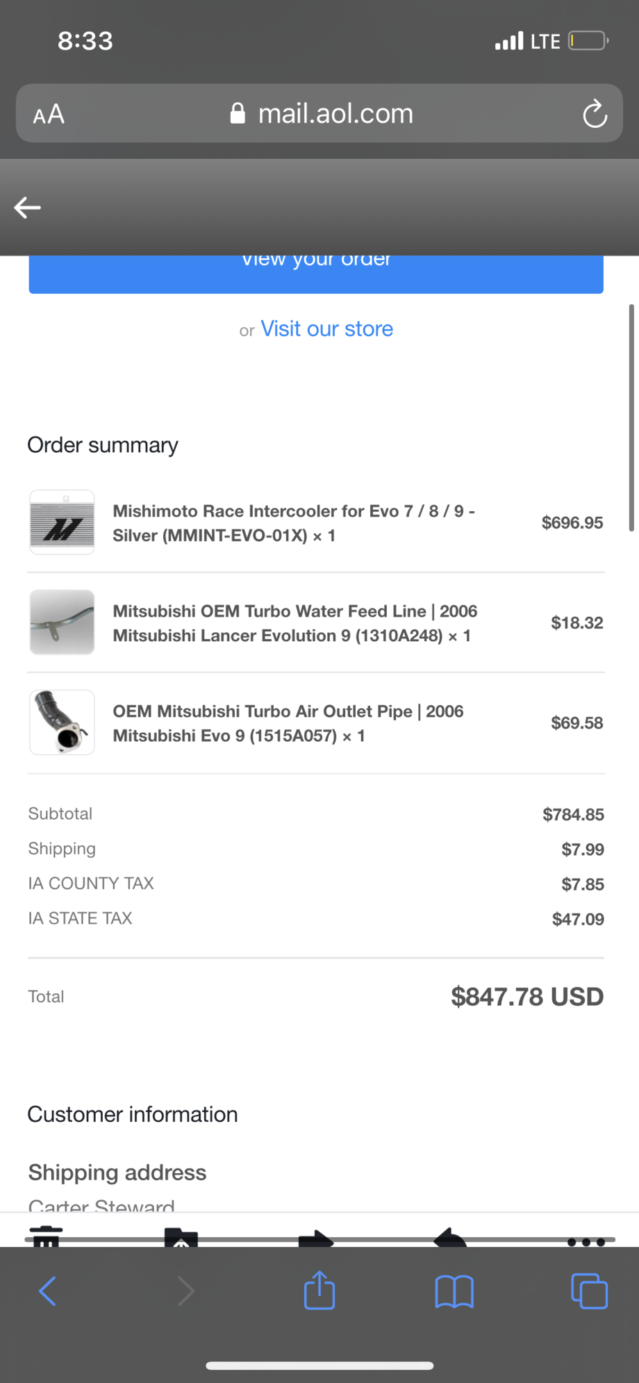

what the... why buy mishimoto, get ETS.
I believe you need to address your PCV set up, i think high crankcase pressure is what breaks the turbo oil seal. check if FP red needs the oil pressure regulator thing. My first 71htr didnt last long without it

Welcome to the boards man! Im happy to see new people coming here to use this place instead of facebook lol . Sounds like a bad turbo to me, I see you have an FP Red on order already. Keep us posted, Goodluck!!!
