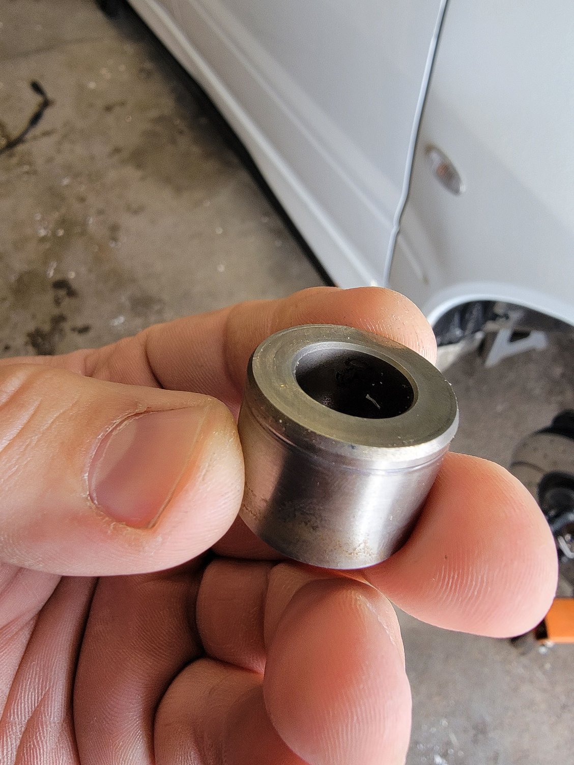

Can anyone tell me what this piece is?
I have been working on my 06 and this dropped out from somewhere and I have no idea where. Someone is bound to know what it is.

What work are you doing to the front end? Suspension work? Looks like a suspension bushing insert? Lower control arm?

I took the trans and engine out when I built it so theres some suspension work in there... and that's when I found it ha. I dont know where it goes I'll have to look at some parts explosions to see. Thanks

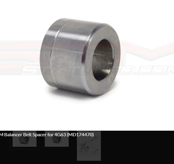

That looks like the spacer that goes behind the balance shaft cog.
Old Feb 22, 2022 | 03:24 PM
Well done @bcollins92 Looks like thats it?

Soooooo...not supposed to be on the floor?

No it's alright if it is. I deleted the balance shaft so everything is okay it was just freaking me out. Thanks guys. It fell from somewhere and I had no idea where I only heard it hit the ground around my workbench.
