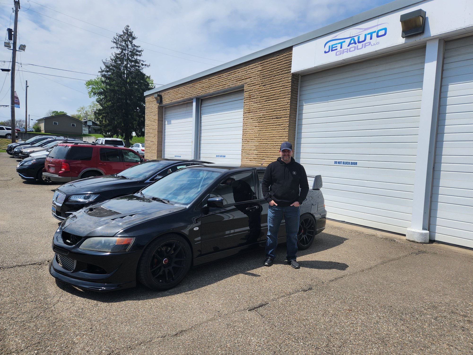

Good morning gents! I recently acquired a 2003 Evo 8 here in Ohio and need some help possibly. The car came with a decent amount of modifications and knowing how tight this group is maybe someone could assist in helping me find out some info on the vehicle. I originally purchased the car to build with my kids, but after looking at it, it may have more mods than I can see. In a nutshell I am trying to possibly track down a previous owner who may have some info on what has been modified on this vehicle. It came from an auction in Washington. It is Black with a slight tear in the driver seat. Someone put a ralliart badge behind the shifter. HKS exhaust with the stickers beside the exhaust. blacked out marker lights on front and rear. Triple gauge swapped with hvac, that doesnt stay in place, as well as the hvac not working properly. I have attached a couple pics to view. Just curious on some of the history of the vehicle.

Congrats dude! Looks good, hope you get some info on it and keep us updated with your search results.
