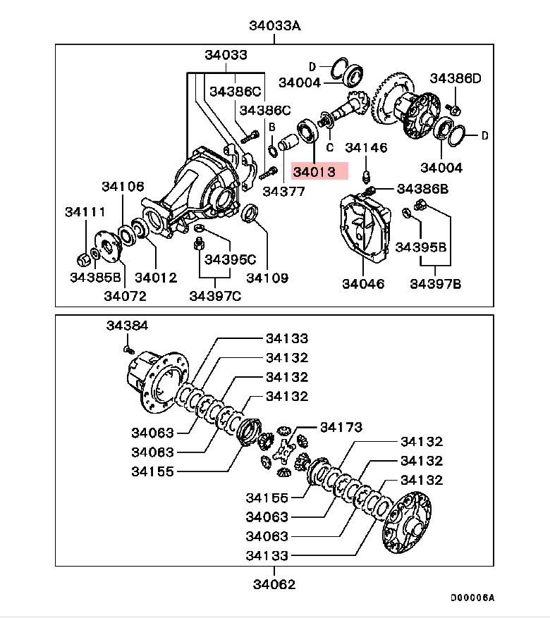

After doing a bit of research, I thought its likely a diff problem either the bearing is worn, or the crown & pinion are out of alignment. I've changed all the driveline fluids in the car, no metal was found in the gearbox, transfer case or rear differential but the noise persists.

It sounds like pinion and or bearing failure.

@Kevin. - I have seen this diagnosis mentioned quite a bit for similar symptoms, ideally I want to confirm that is definitely the cause before opening the purse strings for new parts. Is there a way I can check if the bearing has failed without taking the diff apart? I know there's an inspection opening on the diff housing but I dont know how to check the pinion & crown contact with any confidence. I asked the shop to do this for me but they apparently aren't a gearbox/diff specialist so cant help me there

If it was mine, I'd disconnect the propeller shaft and spin and shake the flange of the rear diff to check for any play. spin from the wheels also. check also the mounting/bearing thingers of propeller shaft. then I'd fill that rear diff to the brim with 100% lucas diff lube and go for a test drive.
