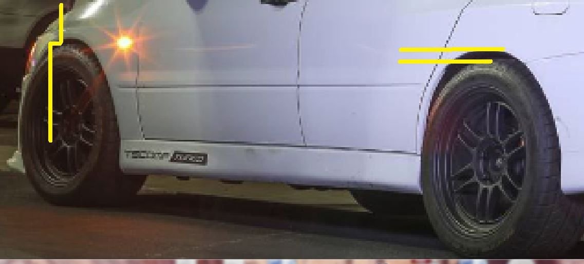

Hey Guys,
I am buying some RPF1's next week and would like some help. I have searched pictures and i just cannot find what I am looking for without digging through hundred of pages of threads...
I want to get RPF1's in 17s. I want to fit the stock body but at the same time fill it out some. The tires i was going to run are NT555 in 255/45/17.
I believe i want 17x9 +35 but I am curious if that will require a spacer? The main issue is the RPF1 face. I need to make sure this offset has the flat face and not curved spokes that the bad offsets sometimes have. Any help or pictures is greatly appreciated.
The picture attached is the ideal look I am going for.

17x9 +35 has a nice flat face and will require a 20mm spacer in the front to clear the stock Brembos. No spacer or modifications necessary for the rear.
I'm running this setup and actually thinking about getting the STM small brake kit for the front to ditch the spacers and move the front wheels in 20mm. It doesn't look terrible, but the front wheels stick out a little too much IMO. Referencing the picture you posted, I'd say my front wheels stick out about the same.

Just be careful w/this example. Its clear to me that the white RS is likely running a rear spacer as well. Look at the rear fender gap. Its gapped for a reason (rub) & a poor example of a proper function fit
Also, as noted, that 20mm spacer has changed the front offset to +15 & that bulbous 45 series tire spec has only made the situation worse. Stick w/a 40 series tire

RPF1 17x9.5 20mm spacer up front none in the rear and no rub and no rolled fenders. I'm wanting to add a 5mm rear spacer but haven't gotten around to it yet. I do have Hotchkis springs and alignment too. I wouldn't run a tire with a 45 profile try 40 it will be much better.

Less spacer, yes, but a 17x9 +22 with a 10mm spacer will actually stick out 3mm further than a 17x9 +35 with a 20mm spacer. A 3mm difference is fairly negligible, so as long as you don't care how far the fronts stick out, and are more concerned with running less spacer, go with the 17x9 +22.

This is my fitment, 17x9 +35 like others have mentioned already. Since I'm not a fan of running bolt on spacers, I opted out in switching the studs to the ARP extended studs. In the rear, I'm running a 15mm spacer to try and get more of a squared setup. In the front I'm running no fender liner at all (CA car) so no rubbing issues there. In the rear, fenders are rolled. Also tires are 255/40/17 RS3s in the picture but now I have evo v12s, same size.
BTW I know the owner of the original picture posted. Same specs, but said he had 245/45/17 tires
