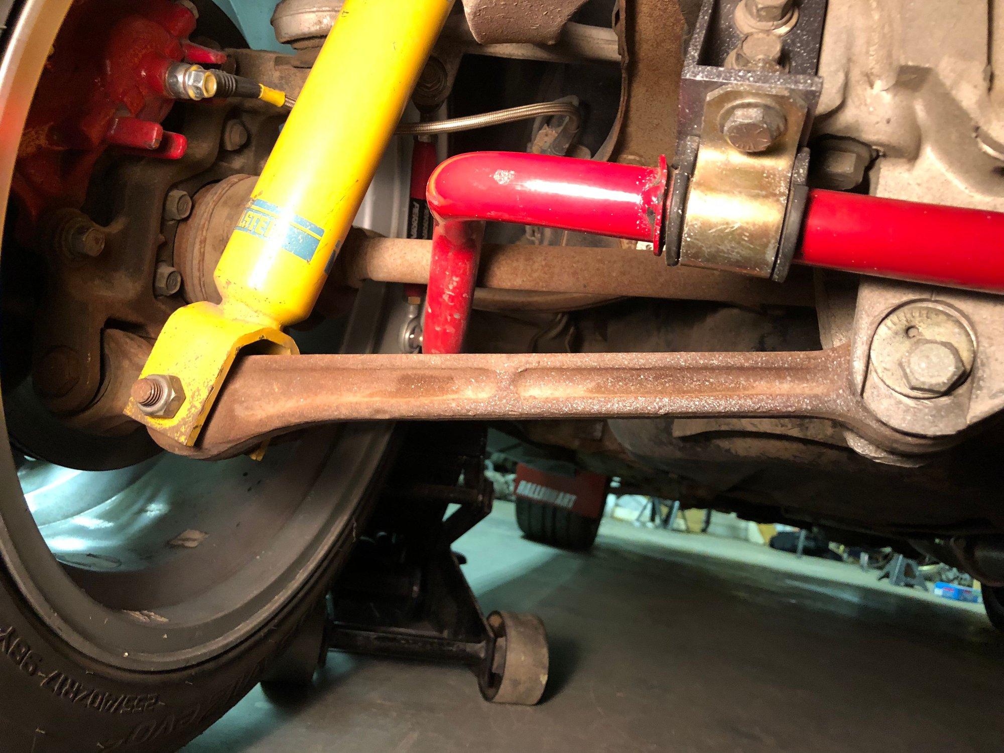

I found a couple of super old threads searching but nothing recent, so here is a new one. Are there any adjustable control arms that you guys would recommend for mostly street driving, with a few track/autox days? I went for an alignment today (the guy who does alignments for a lot of the local SCCA/track drivers and knows is stuff, not joe blow alignment guy) and discovered that with the factory adjustment I can't get any LESS negative than -3* camber in the rear. That is with the adjustments all the way positive. Ideally I would like around -1.5* camber in the rear. My setup is a little different (CP9A chassis and drivetrain with CT9A Bilstein HD's and CT9A factory springs) but I believe the rear bits are all the same between V-IX. So, in order to get my alignment done, I need to be able to adjust my rear camber beyond the factory eccentric bolt and that seems to leave adjustable lower control arms as the only solution.

So this weekend my BWR control arms arrived. They are beautiful pieces and seem to be of very high quality. This week I was able to get them installed, although installation was kind of a pain lining everything back up.
With the new adjustable arms installed I took it to an alignment shop this morning to get everything lined up. The front went pretty smoothly, we were able to get -2.3* camber with 0 toe and between +3.5-4* caster.
In the rear we could easily get -1.5* camber, which is what I wanted, but in doing so, it would throw the toe way out, even with the factory adjustment turned all the way. So in the end, in order to get 0 toe in the rear, we had to move the camber all the way back to -3*.
So, now I’m going to have to order adjustable toe arms too. Together with adjustable toe and camber arms I should be able to get my -1.5* camber and 0 toe. To be continued.
