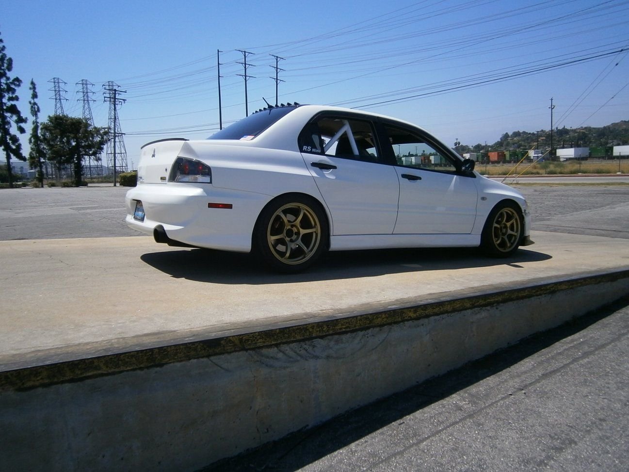

I run 2 similar specs to what youre interested in. Advan RGII 17x9 +29 w/Fed 265/40 & a Rota P45R 17x9.5 +30 w/the same Fed 265/40
No spacers needed. Advans w/the GTR face work really well w/our Brembos but not sure about that RZII
Heres a pic of the Advan setup. Let me know if you have further questions

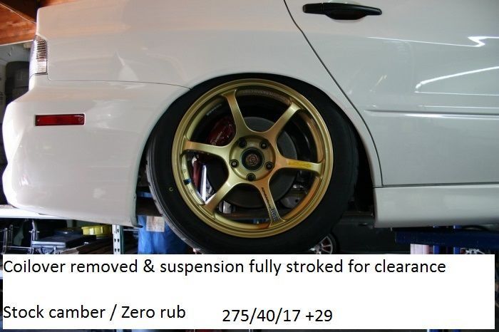

Based on my set 17x9+29 (track setup) & my street set Rota 17x9.5 +30 running 265's you will be needing more than a rear roll if youre looking for true no rub clearance.
But, There are some members that run an aggressive wheel & note, Ive only done a rear roll and nothing more. They fail to note, there is some rear rub under certain conditions. If you are OK w/that type of set-up, you may be able to get away w/a very tight rear roll & some neg camber beyond -2
Let me show you what real no rub clearance looks like. See this fit pic here:
