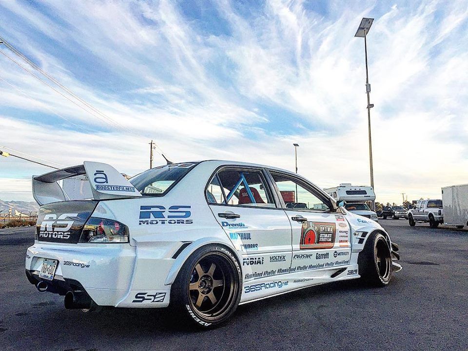

Yea, I was hoping to avoid spacers too, he's running 12mm spacers to clear stock brembo setup, perhaps more is needed for a 6pot setup.
https://www.rayswheels.co.jp/product...=TE37V_MARK-II
Looking at Rays website, it appears that 18x11.5 -20 to clear CT9A factory Brembos :/
