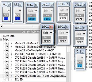

i will read this thread in few moments, but i belive i have did it. see picture.

Are you getting a CEL triggered when the cut happens?
If you have for sure disabled the airflow/torque limiters (making sure the before values are correct before changing to FFFF)
Sure you aren't getting dramatic boost error correction, and sure you aren't getting fuel cut.
Then I would think it is misfires, espically since you said it happens at random RPM.
Is your wideband AFR in your logs correct? If so you are running the car super rich, which can cause misfires.

thanks, for info. it is nice sometimes to confirm what you have read
tomorow i will try to change plugs to proper iridiums and will check fueling for sure. but during cut WB shows - ok.
Values have been ok before changing them to 0xFFFF.
Thanks for info.
p.s. i dont get any CEL's arter update of rom with Tephra DTC code "disablers", but cut is still there.
