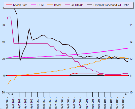

One thing that wasn't mentioned is that rich knock looks different than lean knock. Lean knock tends to result in strong knock spikes where as rich knock tends to come on slowly over several hunderd RPM and stay at fairly low levels, usually a knock sum of 5 or less in my experience.
I've got an interesting example of something that exactly fits that description. It's topical, as it occurred at midrange loads 140-180... a full second of grumbling, low-level knock...
If this is what knock looks like when the engine would prefer a slightly leaner mixture, I'll head in that direction first.
This was throttling on in 4th at 2000rpm, up a hill... so I guess I'm now at the academic end of the tuning phase! I don't go WOT @ 2000rpm in 4th at any time apart from a test pull! So... am I testing a tune, or tuning a test?
Rich
