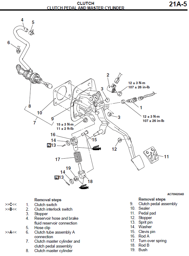

Possible master cylinder for clutch? They use same fluid

I agree, probably master cylinder (#8 in diagram). This should help you understand what is going on under there:
