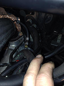

Here a pic of where ill run it from
yupp, take a new hose and go straight from that nipple to the wastegate. then we will see if it still over boosts

same result. boost reaching over 30-35psi and asc light and whatnot.

scratch that the vacuum hose that i used i had laying around split on me. let me find a new piece and retry

really?! wow even when you bypass the boost control it still over boosts... hmmmm, maybe your wastegate actuator is broken or flapper stuck closed... can somone chime in on that???

ok boost peaking around 11ps when hooked up that way with a new vacuum line, so is that a good thing lol? now hopefully that will narrow this issue down a little.
alright, so that tells us your wastegate is fine. since you said the vacuum lines where right earlier its not that. so now its ether in your tune, or your boost control solenoid is not functioning properly.
so you could buy a Manual Boost Controller. then you'll have one, and i think itll fix your issue. and the plus side is, you physically control your boost, not a an electronic device that can have issues like this haha
or you could go to a tuner and have them see if they can still control boost with the OEM solenoid and maybe fix your problem.

Update. I installed a manual boost controller. I disconnected the hoses off of the turbo outlet nipple that was located on the elbow connected to the turbo and the wastegate. Plugged those off and put a line from that nipple to the MBC and then to the wastegate. No cel and adjusted for about 21 psi tapering around 16 at redline. Much smoother acceleration and no overboosting like before. Big thank you to all who chimed in and help me resolve the issue.
