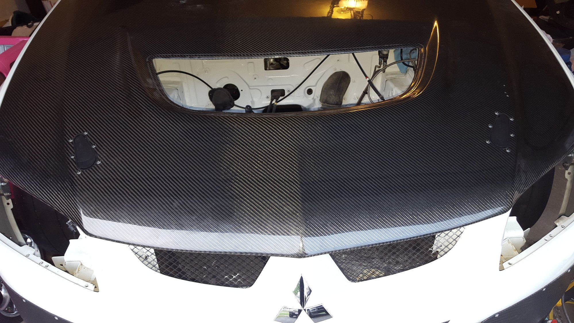

The pins in the aerocatch kit are MORE than long enough. You'll actually have to cut them down to make them work out right.
Here are mine installed, I used the bottom mount pins for a cleaner look.

From: Buffalo, NY
pssst! someone stole your engine!
J/K. that looks great.
