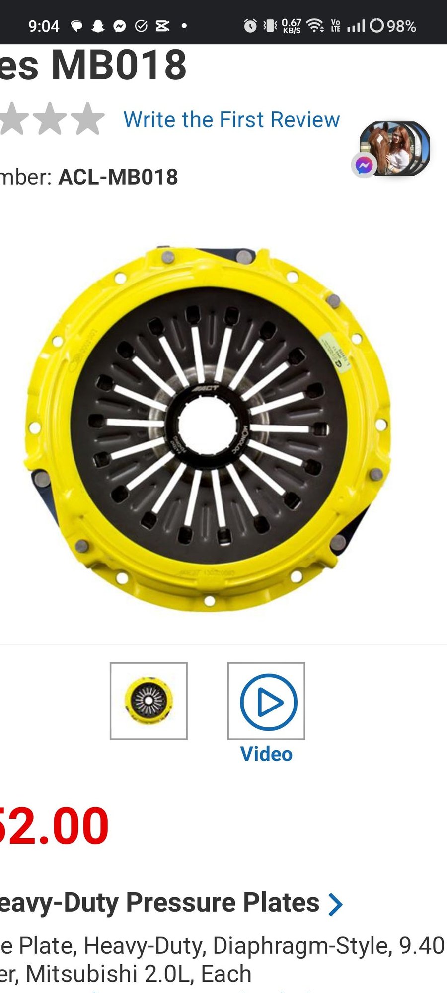

​​​​​​Okay so I thought the pressure plate already had the monolock already installed. This is the pressure plate I installed, is there another piece I need to order and put on?
It says monolock in the center where the the collar should be
Old Dec 20, 2023 | 09:18 AM
mitsuatb's Avatar
Posts: 516
Likes: 55
I agree with ViciousLSD the TOB monolock could be damaged, missing or not engaged.
If you got what's in the picture you do not need anymore parts.
Take the two bolts out of the clutch slave cylinder on the trans and set it to one side.
Pull the clutch fork away from the engine as far as you can. This presses the TOB forward into the monolock.
There is a chance when you do this that the mono lock design will allow the TOB to reengage with the mono lock. If that happens the clutch fork will stay closer to the engine than it was before.
Try and see if you have clutch action.
This is a pull off clutch, when you press the clutch pedal the fork goes forward under slave pressure and pulls the pressure plate off the clutch plate freeing it up.
If this doesn't give you clutch action it is likely that everything needs to come apart again. Be sure to read about how to disengage the TOB with a long screw driver through the inspection plug on the bottom of the trans.

cool if you have a monoloc and didnt stab it.
try to manually turn the motor by the crank pulley bolt then reengage the TOB, it might take a few tries. the collar might be at an angle
