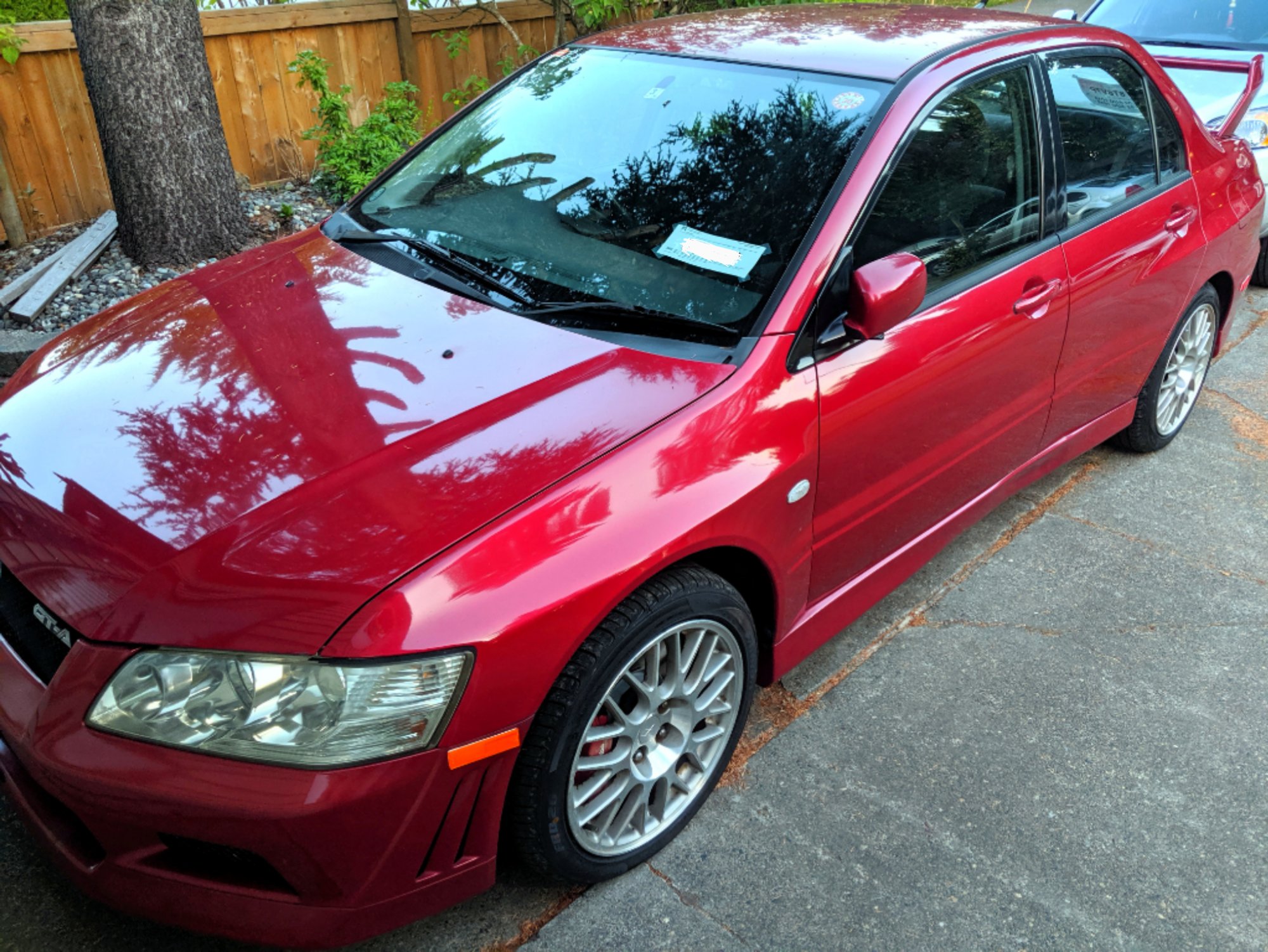

This looks like it is going to be a great way for me to finally learn about transmissions. I agree that it would be easier to replace the LCD screen but the one in my car is in a different much higher up and further back location than the Evos without the huge control center. To access it requires buttons even having really long arms. Do some aftermarket LCD screens have connections that allow you to wire in buttons that would be on a steering wheel or in this case right in front of the LCD?
Does anyone have any links to a topic or article depicting everything needed to turn a Evolution GTA into that Evolution 8 I believe that came with 400hp or close to it right from Mitsubishi? Is a Garret turbo dual ball bearing or a just as good if not better new Borg Warner turbo going to be a better option than any Mitsubishi turbo? I have heard that replacing a torque converter in automatic transmissions can help with turbo lag.
Most important is there an article with the strength of stock internal engine parts somewhere? Someone on a Evo forum told me the connecting rods needed to be replaced in order to be strong enough to handle the high torque that would come with 400hp.
Does anyone here use automated water/methanol/windshield washer fluid injection into the intake to cool down temps and act like higher octane fuel? Is it common for people to route the rear windshield washer fluid jet to spray the intercooler to help with heat soak?
My first plans before adding horsepower are to reduce weight by taking out the spare tire, tools, old huge DVD player, possibly the rear seat and maybe the rear wiper plus motor. I also know that the $800 tiny race car batteries they sell with carbon fiber casing are also sold under a different name for less than $100 without the carbon fiber casing so I plan to install one of those as well. I really would like to get the car down to at least 1,200kg and hopefully further when I get around to making carbon fiber parts.

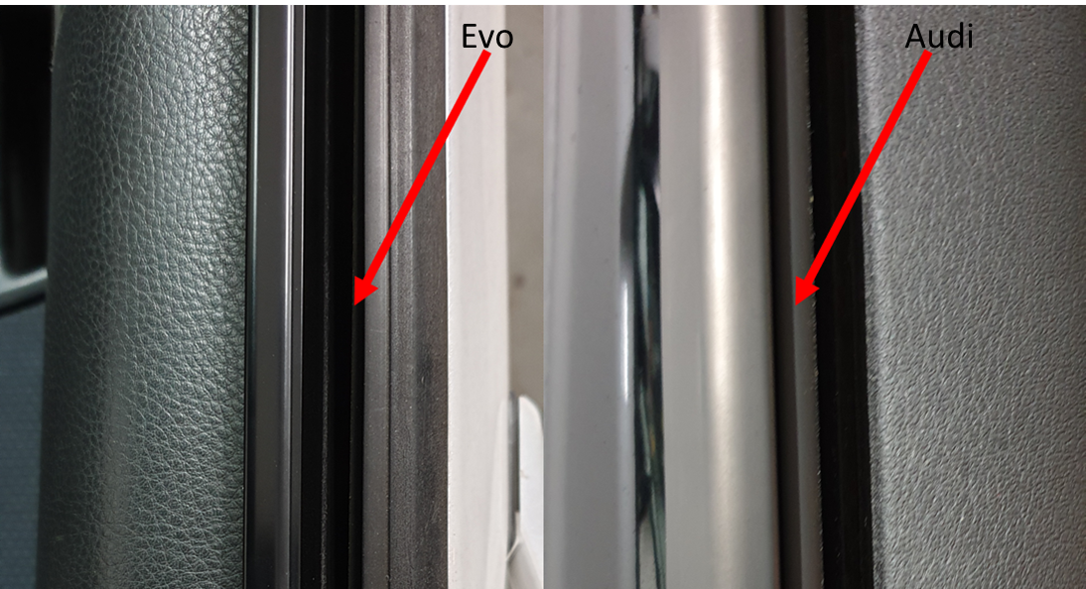

What is up with the lack of door window stripping/rubber sealers? Where does it drain or am I missing them?!

I think somone stole your rubber seals...

Oh and e85 is not available here in British Columbia Canada at most gas stations. We have 98 at one brand of gas station which is why a water/meth kit really would be needed for me to get high boost. It is not tuned for Canadian gas yet either so no red lining it. Is there a particular open source tune people use on this car? I found some info on this board about using a particular guys tune but it is for the regular Evo turbo not our small inlet turbos. If I cannot find some good open source tunes I might take a class in person to learn how to tune and start by tuning my Turboed Jetta to get the extra 40hp available from the ECU alone. Unless everyone here thinks you can actually become an awesome tuner just by using online tutorials and videos...

The importer seems to think that they're window seals otherwise it would already be leaking. They would have to be below the hard black plastic trim next to the window though that you can see in the picture.

Yeah the seal is not obvious, its quite recessed, small and doesn't really feel like rubber. I took a look at my Audi which has a much larger more obvious exposed rubber seal, if that is what you are used to with VWs.
