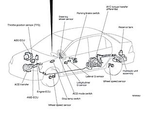

All I am saying is that the drawing had to be recreated it is not just dropped in by mistake. That does not mean that SAYC is coming either. The fact that no Evo has yet had a differential pump in the front of the car is still true. The VII & VIIIs share the rear pump to supply both active diffs. See the enclosed chart.
I have a MR on order so either way with or with out SAYC would be fine. SAYC just gives more tuning options.
