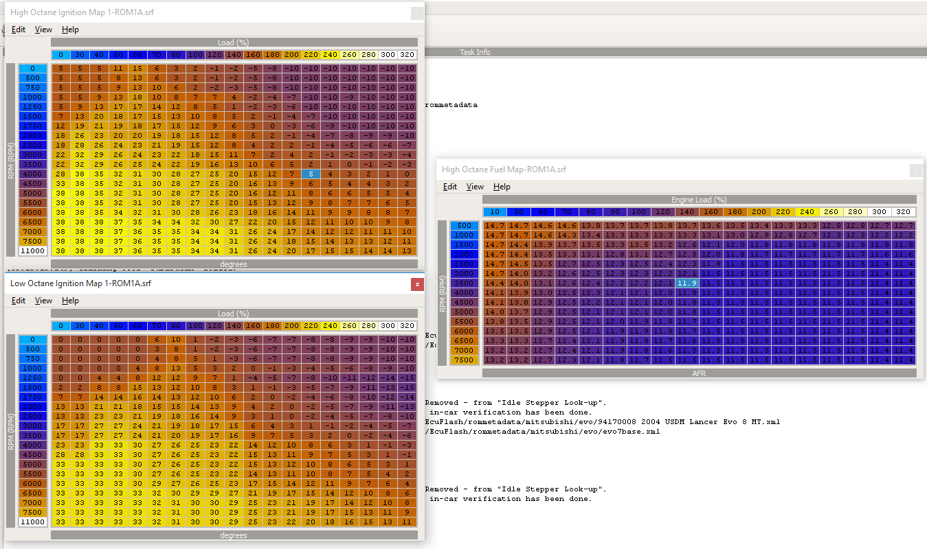

OK, I finally got some info from the tuner.
Attached is the evoscan log and some screenshots of the maps.

You are pegging the knock sensor. Either a very noisy engine or a knock sensor problem or the car is very lean. The mid fuel trim is at +10 to so your inj scalling is out and the car may be very lean under boost.

Thanks for your input. Going to check the torque on the sensor that was install by a shop. its just been frustrating after 1 year and 4 different tunes and no body can figure out why it knocks at 100% throttle but goes away as soon as you let off the gas. Any recommendations on plugs and plug gap?

OK, so lets be honest, it has been to multiple tuners and yes there is no way I'm going back. I did get the ROM sent to me and now have access to all the maps so if anyone has any questions or would like to see any of them let me know and I will post more pictures. Thanks for any type of help.
