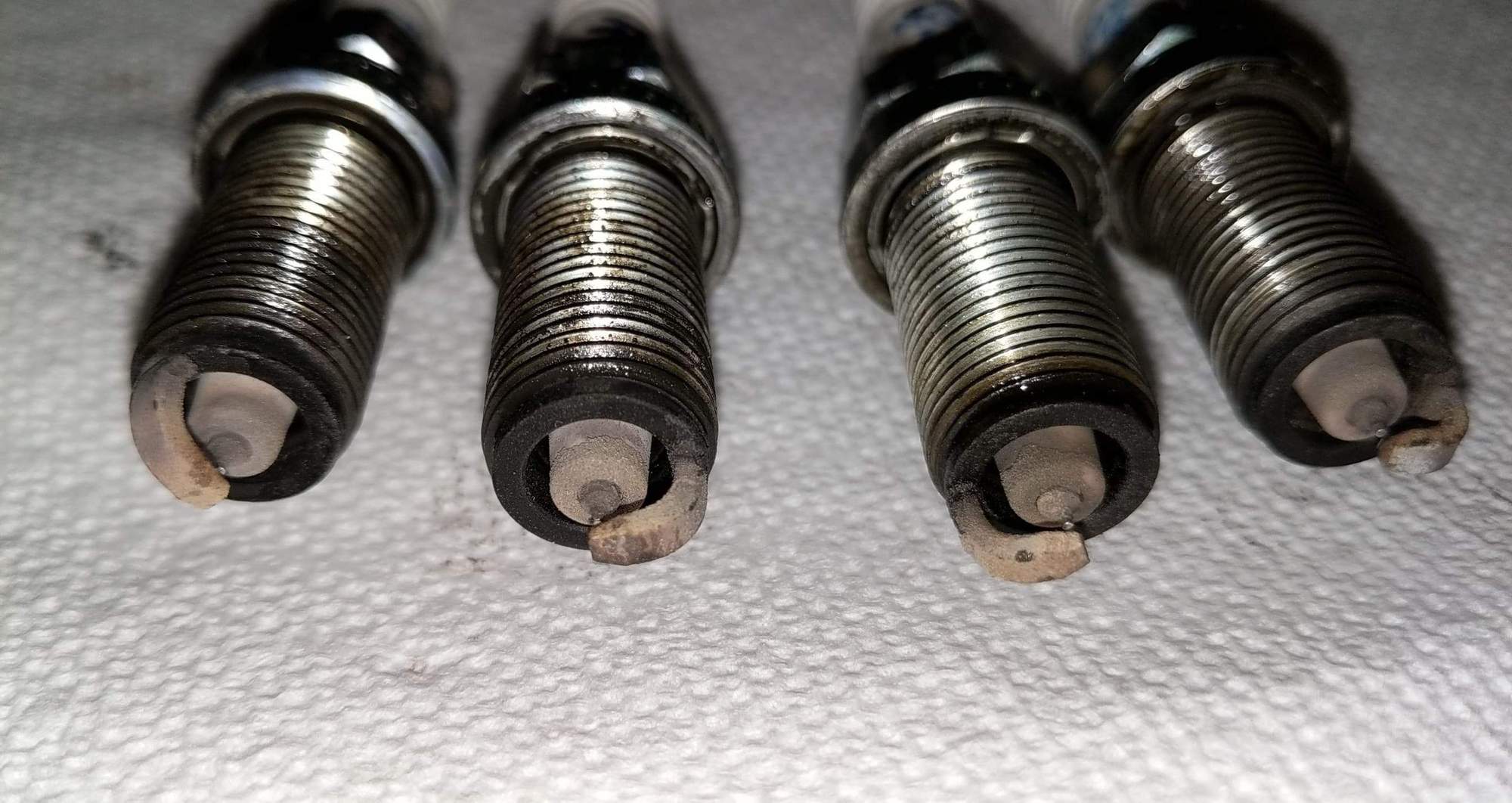

pulled the plugs and replaced then with NGK R7437-8's gapped to 18thousandths. These are the old plugs gapped to 22-23 thousandths based on feeler gauges. Car starts significantly better(first crank vice 3-5 seconds of cranking) but it may just be from the warmer weather. I have new tires on order so I'm waiting to try more pulls until the rubber is replaced.
