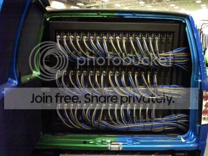

Hey, original poster -- don't feel too bad about the price of wire. Check out the Kicker van:

Thank You I <3 Kicker Wire, I miss getting team pricing lol

Hey, original poster -- don't feel too bad about the price of wire. Check this kid out:
damnnnnnnn wtfff hahahahaha
