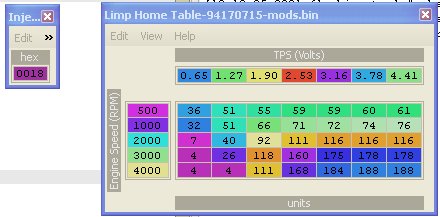

Ok, so first, i did try reducing the injector latency value in the 11.75V and it didnt seem to do much unfortunatly :-( So whats the "limp home"? i see that table in my rom, but what exactly does that control, i noticed it was TPS volts and RPM? Also where can i find those values from the 9417 ROM, does anyone have have that rom so i can look at these values?
About the lancer base latency, mine is set at 000F hex, is that the same when you say 0xF?
If you download the SD 9417 rom in the ecuflash forum in I think its post #2 it should have that table. If Not I can always post it.
The 000F is the same as 0xF the 0x is just shorthand for hexidecimal which is how you would enter it into ecuflash.
The Limp Home table is supposed to be a backup table if the car looses sensors and needs to fall back on a simple alpha-N strategy to keep the car running but get you home. The weird thing is this table seems to be used in startup and I'm not totally sure why.
The latency base is a multiplier which relates to the battery voltage value higher values mean more resolution AFAIK.
Ok, thanks for explaining that info! ill go look for that rom, open it up and i want to copy the values in the "limp home" table in 9417 and input those values in my tephra rom's "limp home" table and give that a try?

You put the xml files in the rommetadata/evo folder?
Also you can't have ecuflash open when adding definitions it only reads them on startup if you did you have to close and open it again.
Give me a minute and i'll post it up
Edit:
Alright, thanks RS! i did put them in the right locations, i dont know what happened, it seems to work now. ok so ill copy these into my limp table and change my injector base, ill log a cold and hot start and report back!
