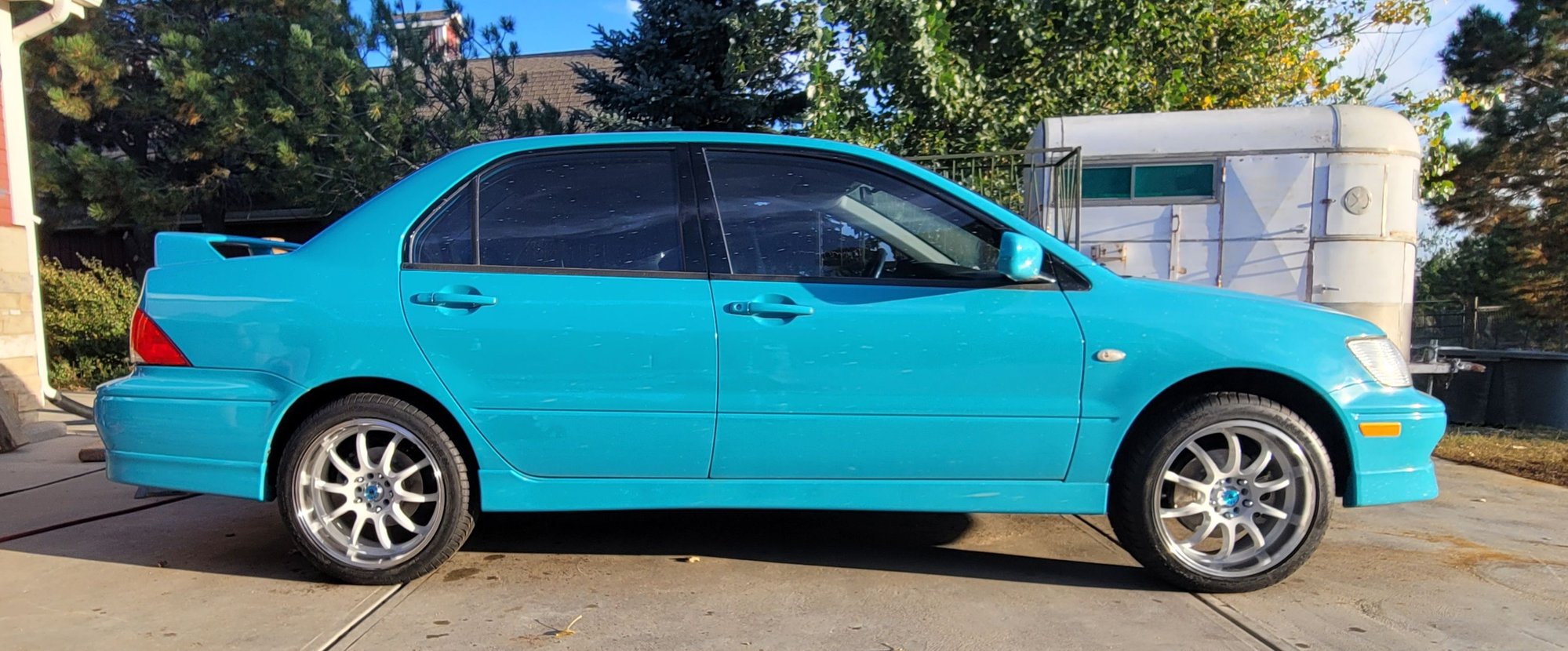

Suspension issues (busted bushings) and brakes forced the 5-lug swap to come sooner and be prioritized. 5-lug swap went pretty smooth once I got all the parts together. Took a while for a ralliart to show up in my local u-pull.
Here's a link to a picture in case the forum drops the image... (https://i.imgur.com/wjAecnU.jpeg)
17 x 7 koenig lightning wheels. Cheap 215/45-17 tires from tire rack.
