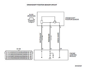

Help.... Helping a friend on 2010 lancer 2.0 non turbo'd. Code p0335 ckp sensor malfunction. Tested and replaced sensor. Ran for 1 week and crapped out again. New sensor seems to test good. Does anyone know the pin locations on ecm connector and what resistance values should be there. Scanner shows constant 113 rpm koeo and cranking. Pulled the connector and inspected, looks good. No other codes. Any help would be appreciated!!!

What the manual says
The most likely causes for this code to be set are:
•Crankshaft position sensor failed.
•Open or shorted crankshaft position sensor circuit, harness damage or connector damage.
•Crankshaft position sensing ring failed.
•ECM failed.
Here's evo x ecu wiring diagram, same as base lancer but with few extra pins.
http://www.roadraceengineering.com/e...-ecuwiring.htm
You're looking for pins 8, 9, 24

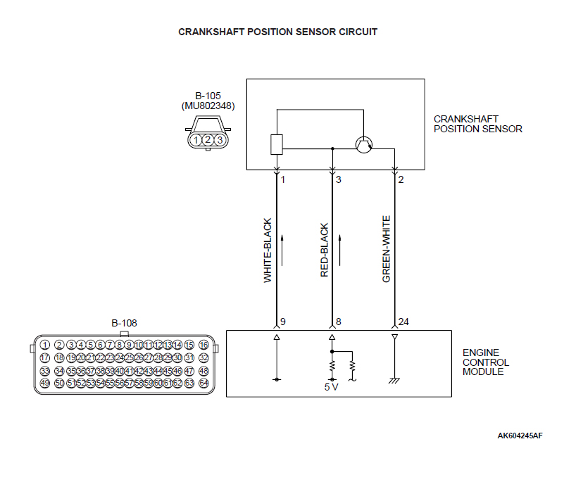

Here's the diagram of Crankshaft Position Sensor Circuit
Hope that helps.
