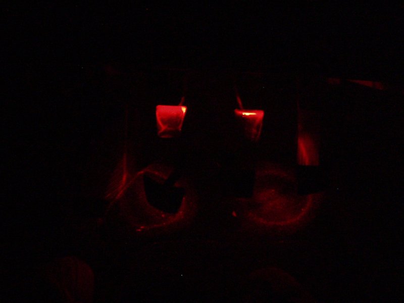

Well i finally did it, i put LED's in my vents and now they light the floor of the car, there in red, so if you dont like red just imagine your color!

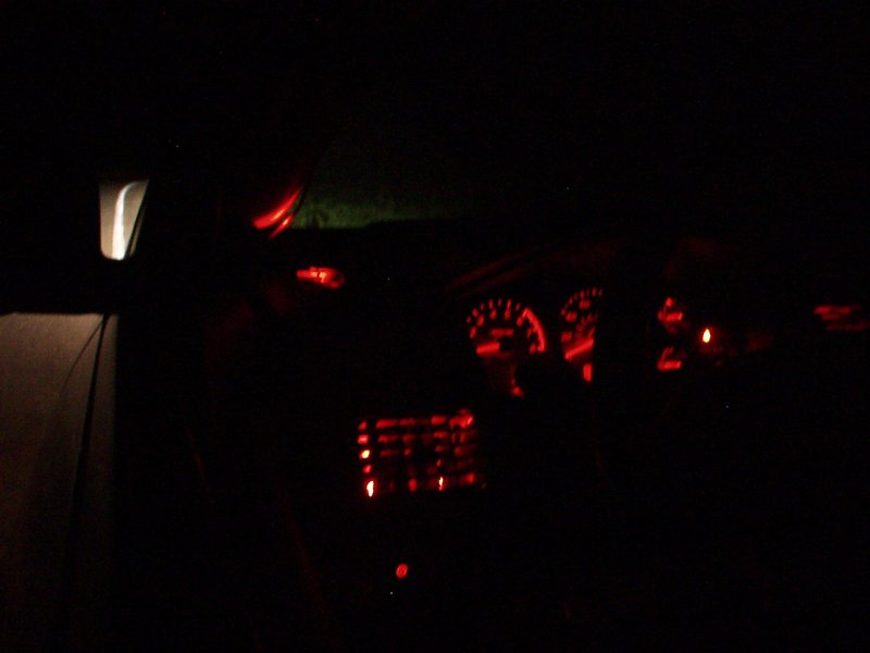

another

and another

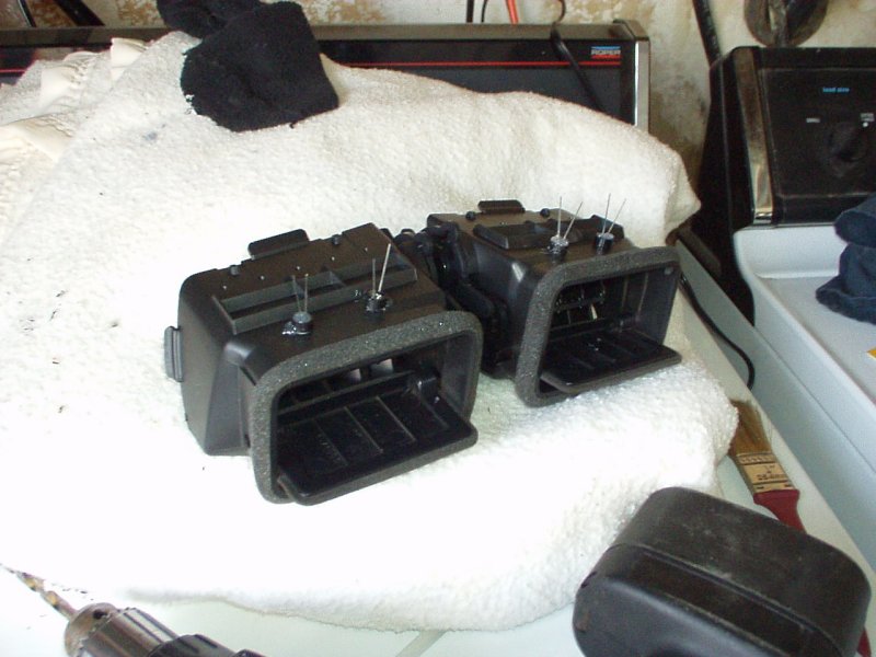

center vents
here are the center vents with two holes drilled in them and the LED's sticking out the bottom

Lookin' good. As much as I hate red (can't stress that enough) you did a real clean, professional job with a nice result. I woulda put em on a switch personally, but your way's second best imho.
Way better than neons anyday. Go soft light!

i got mine at radioshack, since i work there i was able to try all the LED's and decide on which ones i wanted
if you go there, the LED's i used are 276-309, and if you use the same LED's you have to wire a 680ohm resistor to the longest side of the LED for it to work or you'll blow your LED(s)
