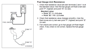

I'm not really sure what your question is. If you're asking what the Ohm reading is on the factory sender then check out this page from the FSM.

thanks for the diagram...im looking to change my stock gauges to digital and some of the fuel gauges that i saw said something about the ohm level sender...
