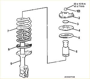

check this out.
Link

You talkin about 1N in the picture? That is the top bolt for the spring. if so, an impact wrench will do the job nicely.
Old Aug 15, 2002 | 10:46 AM
Barse's Avatar
Joined: Feb 2002
Posts: 82
From: Alabama, USA
My bad, meant nut...not bolt...been a long day.

well i have the whole assembly off... it's 10pm and i'm still trying to think of ways to get the nut off. damn...
i basically have in front of me that pic Link286XT has posted. i tried getting that 1N nut off with an electrical impact wrench but the bastard wouldn't come off. i have no way of holding the strut steady to get the nut off... i'm pulling hairs here!!!

heres the pic your requested.
Link
