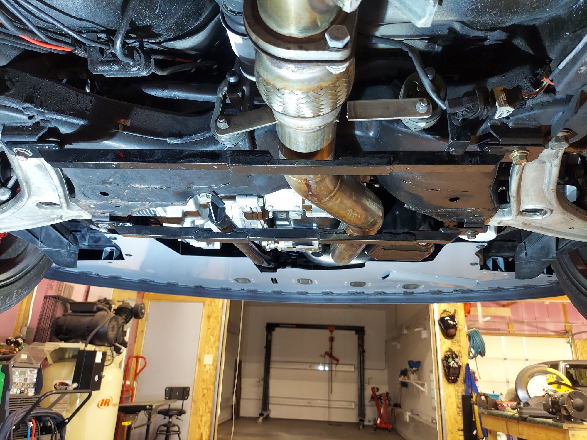

Good luck- I was in the same shape as you about last year. I ended up tig welding custom ones to replace my stock ones. Saved a good bit of money, and got a better result as well.

Here is a picture if anyone wants too see.... this only took a few hours once I figured how I wanted to solve the challenge of keeping the downpipe from contacting the braces. For me the trick was to cut a notch, and then put a reinforcement on the underside to compensate for the structural opening created by the notch. I even made a little bracket with a wiring locator so I could mount the connector for my wideband if it was originally designed like that... These are made out of aluminum square tube and are lighter than factory. If someone wants to replicate it's not rocket science.
