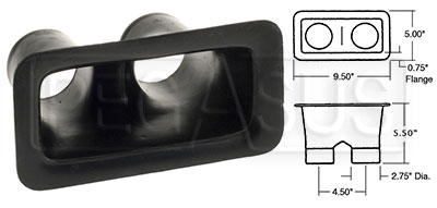

Originally Posted by Ludikraut
Don't do NACA ducts on the headlight deletes. You want a ram duct (i.e., large round hole tapering down) since it's forward facing.
l8r)
I'm not following you on a 'ram duct'.
Unless you're talking about doing something like what Seibon offers (1st pic). But that doesn't seem a whole lot different than our idea for dual NACA ducts slotted into the headlights:
or
or
The first, clear one is a NACA duct. Would go on the side of the car with air flowing across the front of it, not directly into it.
http://en.wikipedia.org/wiki/NACA_duct
The second, black one is more like what Ludikraut meant by ram-air duct. It would go on the front of the car or a surface where airflow was flowing directly into it, not across it.
I like that black one - good find!
