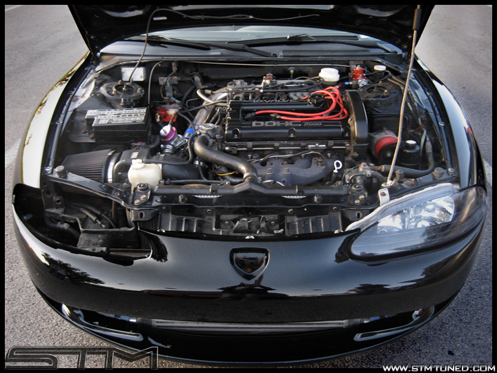

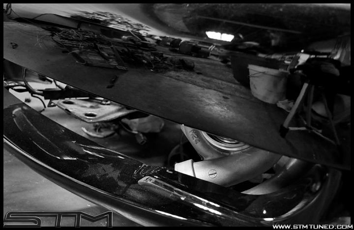

This car has already gone a 10.9@126 on the stock motor... next time around we're going to push the factory 4g63 a little harder and see where it will take us! This car has already lost a ton of weight since then and we are planning on a much more efficient set-up (what with the turbo stuffed in the front bumper and all... I think STM has a thing for that

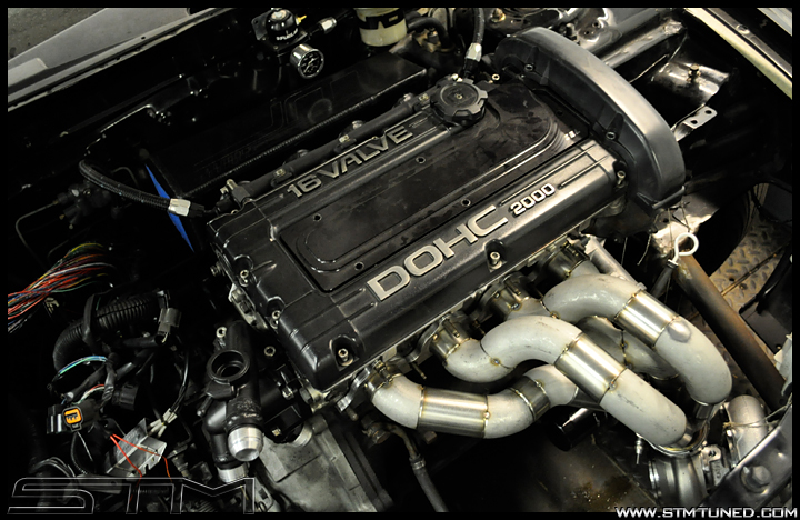

Here's a few of the other goodies going into this car...
Yup, that's the hottest valve cover on the planet.
Cory, you gotta get that compressor cover done black though.
I just like to see all the black parts together

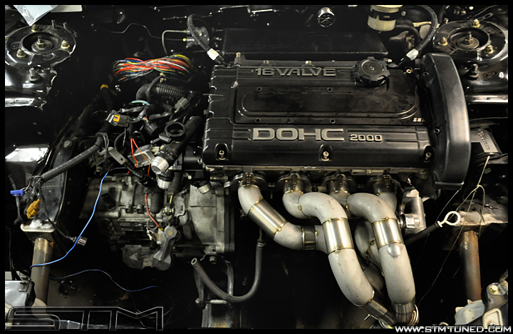

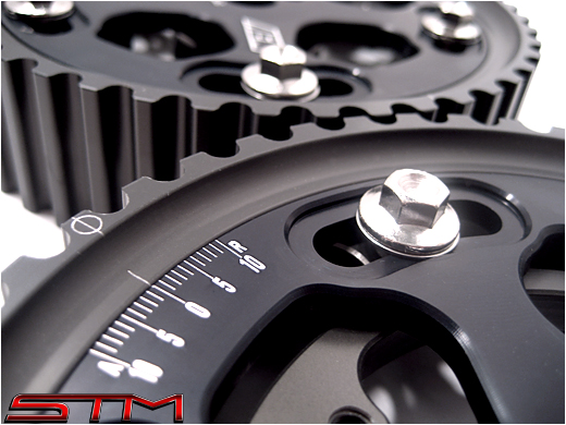

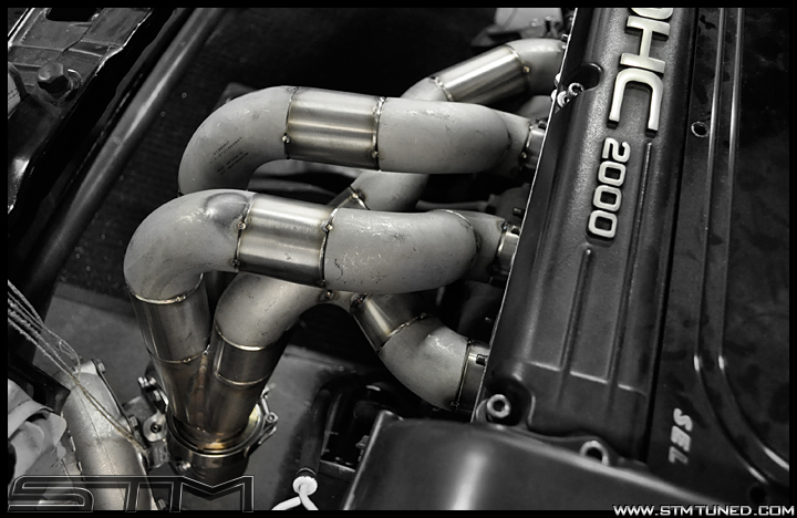

Pulled out the BC cams in exchange for a set of Kelfords. While I was in there I took care of the valve stem seals that had been plaguing me for the last couple years (as you can clearly see...yuck) and did a new set of springs and retainers.
To go on top, a cover I did a while back. All cleanly shaven with -8's welded in done in satin black. My new intake manifold polished/anodized. Fuel rail that may need a coat of paint as blasting it before the anodizing process turned it a little gray for my liking. And of course STM's tank to rail and return kit.

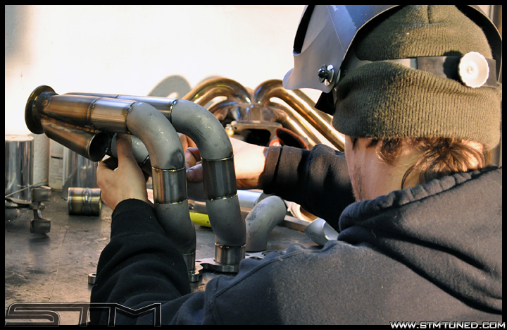

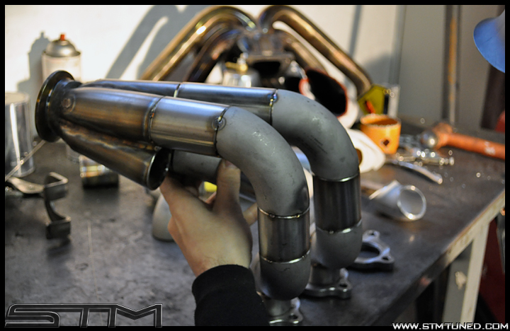

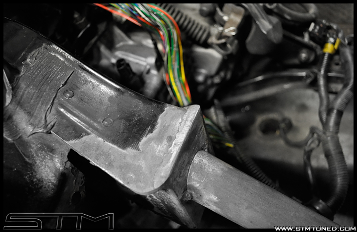

Ends of the rails have been capped and a lower bar has been tacked into place.

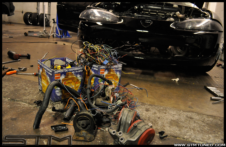

I've also picked up the tig torch and started playing in the last few weeks (literally). I'm not sure which catch can I'm using yet, but im sure you can see where this is going...

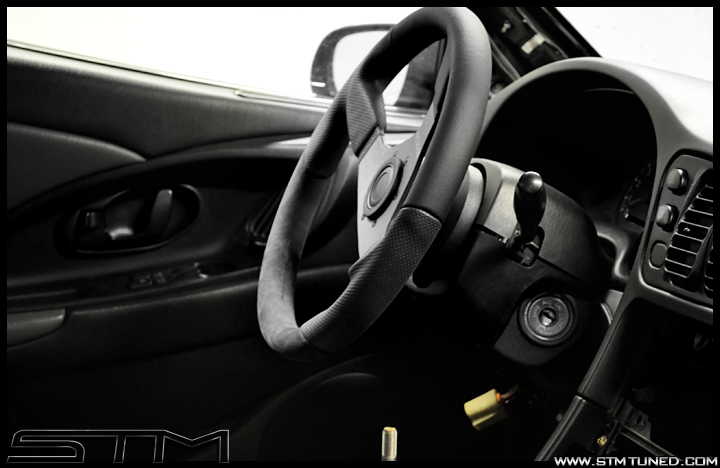

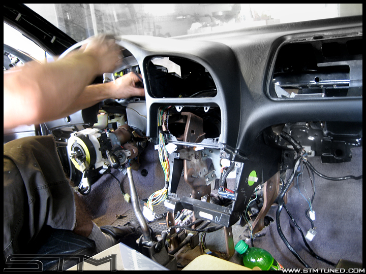

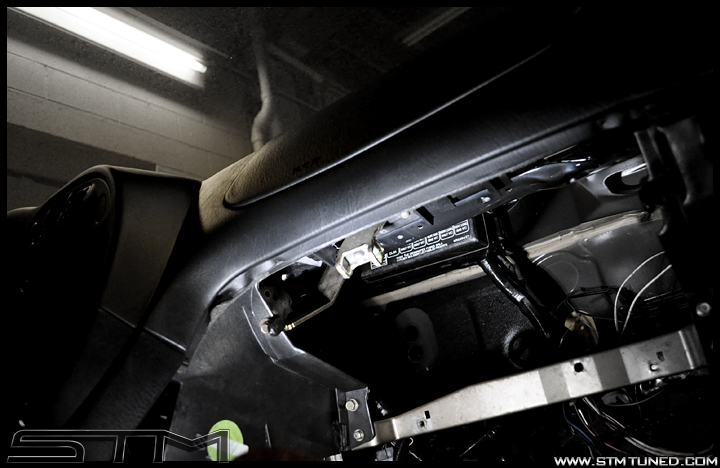

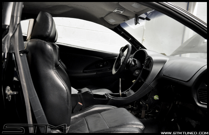

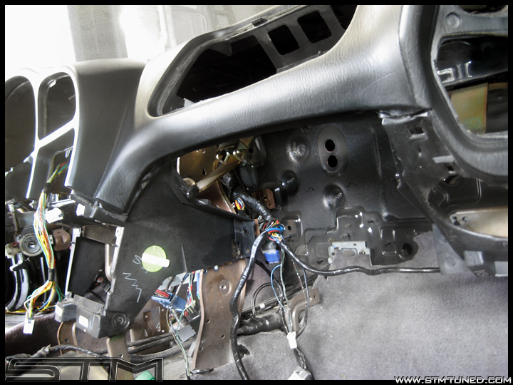

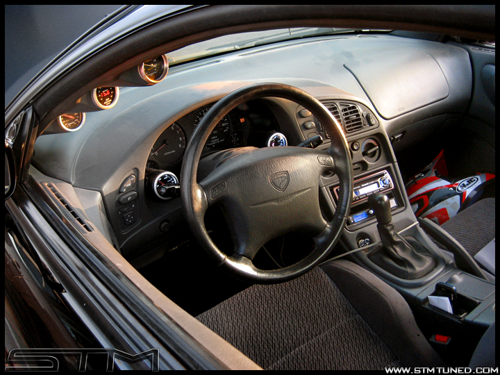

Scored a decent set of black leathers and finally got the ambition to ****** the remaining black pieces from my rs. In doing so I removed close to 150lbs in the interior alone!! Not too sure how much I've lost overall, I'll be happy if I'm 2750ish while keeping all the stock body panels and stockish interior. Can't bring myself to do the carbon thing yet.
Gotta do something about the carpet...
