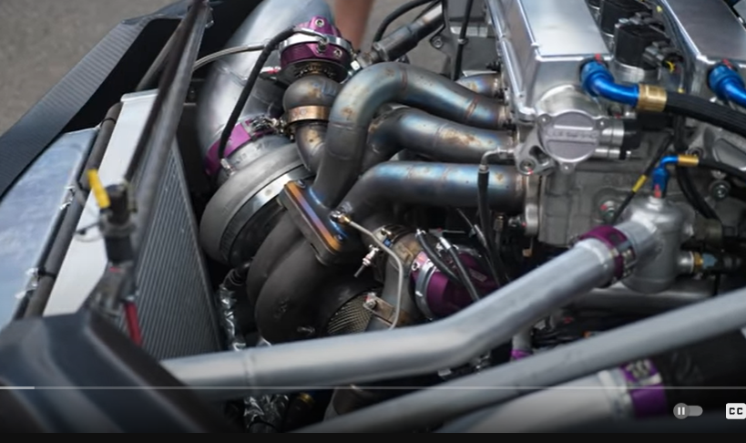

what is it about those artec exhaust manifold + o2 housings that are creating such gains in power? it seems like people are regularly hitting 400whp on stock turbos with those insanely expensive parts
Ayoustin Jul 25, 2023 07:37 AM
It's a well designed manifold and the larger O2 housing helps reduce exhaust backpressure after the turbine wheel. I wouldn't attribute stock turbos over 400 to just those parts tho.
They're certainly not insanely expensive, most tubular manifolds are in the same $1000 price range.

It is really nice stuff but you need a reverse rotation turbo to run their cast manifold on a CT

Yea that part is always painful with turbos on these cars. Xona and Garrett are really the only decent options. I've been hounding Borg to do reverse rotation EFRs for years but they haven't had enough demand.

Could you delete the power steering pump and then have an Artec Cast v-band manifold with a non reverse turbo with the turbo inlet behind the right-hand headlight?

Ayoustin Jul 26, 2023 04:30 PM
Would probably work but would make for some awkwardly tight radii to get the exhaust downpipe routed and I don't know what clearance to the front motor mount would look like. The Tilton car is like this, albeit it's a large EFR mounted on a custom manifold, but they had to cant the compressor upward a pretty far amount to get the exhaust pointed the right way. Basically what I'm saying is anything is possible if you try hard enough and throw enough money at it.

Tilton also has cut the rad support and gone to a custom half radiator.
Thats the other issue if u stay standard rotation and standard direction youd have to come up with another solution to the radiator. Rotheli racing had a v band setup which you could do but its pretty extreme and probably cheaper to just buy the right turbo. Im just gutted because i purchased a new garret G series about 3 months before i first saw the artec manifold

I'm not sure why that would be a hang up. The packaging/fitment is much better with the RR turbo.
